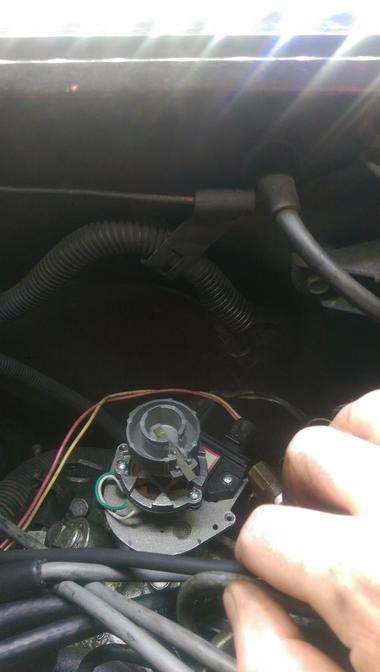

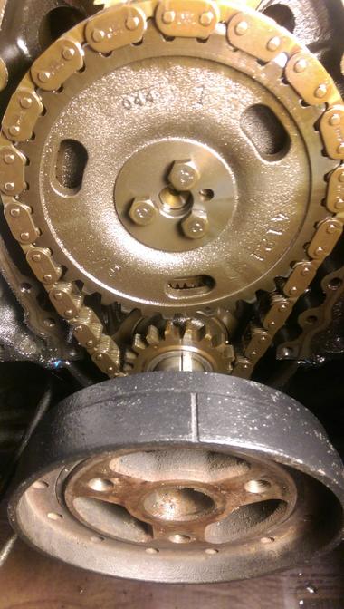

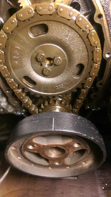

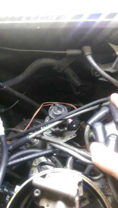

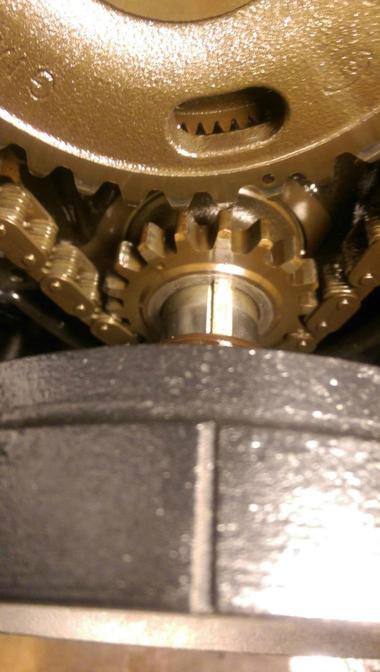

slicedpi 08-08-2015 02:34 PM
5 Attachment(s)
I took some pictures of the marks.
Here is cylinder 1 at TDC:
Attachment 3532
Attachment 3533
Here is cylinder 4 at TDC:
Attachment 3534
Attachment 3535
Attachment 3536
In both TDC positions it looks like the marks are not lined up. I'm going off of the mark on the balancer for each cylinder being at 12 o'clock, and the fact that the rotor pointing at cylinder 1 terminal is lined up with the mark I made on the base of the distributor when I changed it.
So judging by these images, is it safe to say that the timing chain has jumped teeth? Can I remove and realign the existing chain set? Or do I have to replace it with a new one?
