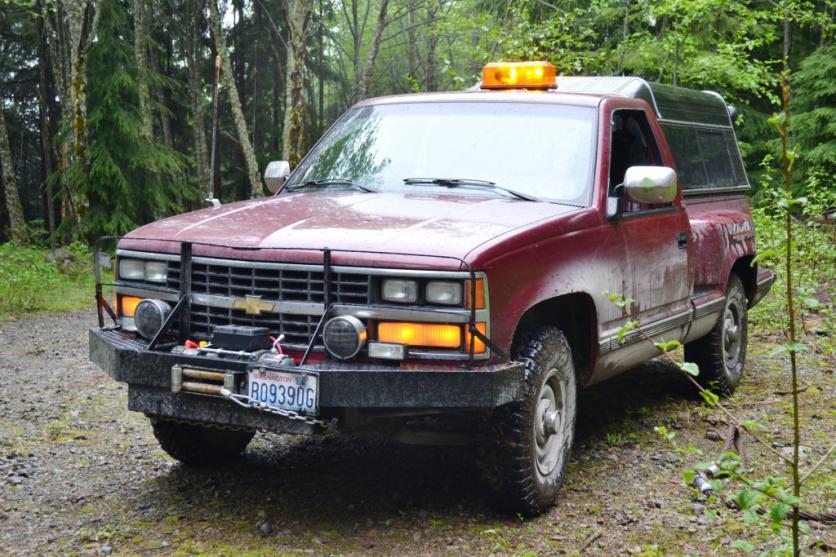

The uneven idle, wierd codes and performance issues could be a bad intake manifold gasket...mine was sucked in between 2 & 4 just enough to cause problems. Once I changed that it ran like a whole new engine. Cost: $12 for a good set of thick gaskets and $5 for Permtex type 1 ('a' or 'b', that just refers to the tube size). I don't use silicone sealers in my engine, but what you use is up to you. if your intake manifold isn't perfect, nothing else will work right. That goes for the seal between your TBI unit and the manifold. Have you put a vacum guage on it yet?
While ya got it off....it's an '88? Is it now pollution-check exempt? Mine is now, at 25 years.
I didn't take the smog pump off for now, as I needed the roller for the belt. However, I gutted it and now it is just a spool. I took off all of the associated hardware, plugging off the nipple in the TBI. I took the tubes off the exhaust manifolds, cut them down and flat-rolled them like a toothpaste tube. I took off the EGR and cut out a metal patch to seal off the manifold. I removed the cat and replaced it with a straight 3 inch pipe to the single 3 inch Flowmaster exhast. I set the ignition at 6 degrees, but be sure to disconnect the knock detector first or you will have headaches.
The truck runs so much better now that you just wouldn't believe it. Total cost is the gasket, Permatex, and less than $50 for the exhaust. tubing.
