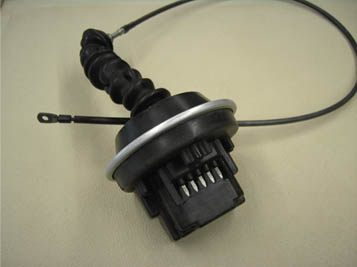

Look under your hood for one of these:
If you see one, then most likely, you have cruise control. It also looks like RPO code (Found inside the glove box) K30, K34 and K35 are cruise control options. If you have that RPO code, and it is your original glove box, then technically, the truck should be outfitted with cruise control. Then just buy your multifunction switch accordingly.
