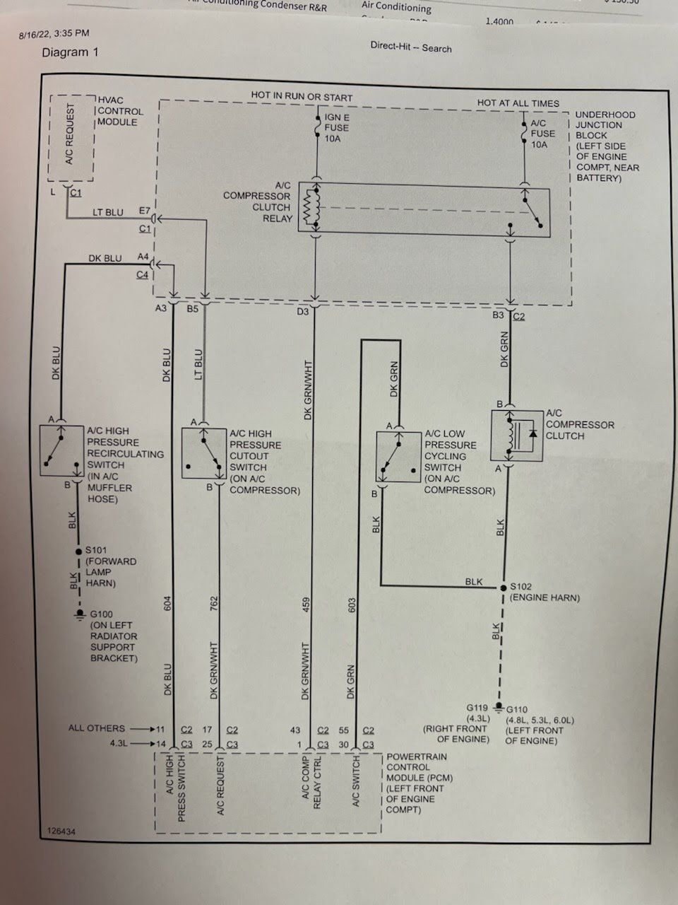

My local shop owner sent me over the attached A/C diagram... From this diagram - am I seeing it correct - that the signal to cycle the compressor clutch is sent from the PCM ??? *WHY the heck do they have an AC system going through the PCM? Seems like it should be it's own external module)
On a whim - with the a/c running - I disconnected the wiring harness from the low-pressure switch (on the accumulator) - the compressor cut off as expected. plugged it back in - and it came on. I did the same for the hi-pressure switch - and the compressor stayed on. That tells me that (possibly) somethings is elsewhere - holding that line's signal as a closed circuit - and not allowing the compressor to cycle... Bad clutch inductor? Bad PCM? Frayed/chaffed signal line that's shorted/grounded? Do I need to back-probe the signal lines while it's running?
