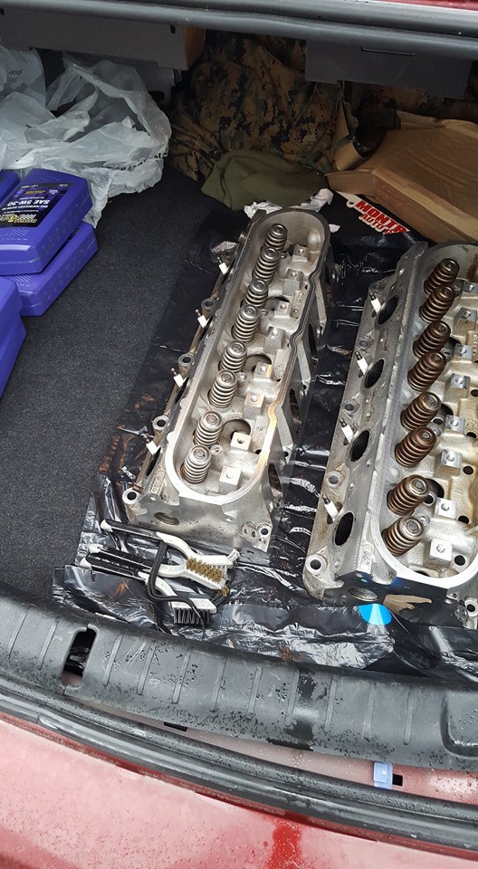

Dansic 12-11-2015 07:58 PM
16 Attachment(s)
Attachment 1664
Attachment 1665
Attachment 1666
Attachment 1667
Attachment 1668
Attachment 1669
Attachment 1670
Attachment 1671
Attachment 1672
Attachment 1673
Attachment 1674
Attachment 1675
Attachment 1676
Attachment 1677
Attachment 1678
Attachment 1679
Dansic 12-11-2015 08:03 PM
I wasn't able to put the engine in over my 30 days at home. The machine shop took 23 days to get it back to me just to bore, hone, and put the new cam bearings in. Super pissed. But I'm going back for another 12 days on leave for Christmas. I will continue starting the 18th! Until then I crated it and everything else. I've done everything besides the boring and cam bearings myself. Even surfacing the heads and lapping the valves. I used a slab of glass and sand paper to surface the heads, and just some lapping compound on the valves.
