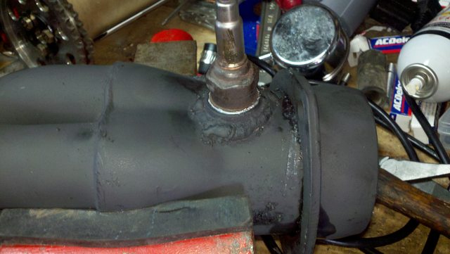

Do you have any kind of custom tune or wiring harness made for it? If you put shorty headers on it, do the new shorties have 02 bungs welded in the collectors or the runners? Your engine will run ****ty if the sensors are in one of the runners. You gotta have them 02 sensors in the collectors, or in the Y-Pipe right after the flange at the very least. Honestly, this is what I did for the headers on my Firebird when they got installed. Hole saw and my buddy's welder.
