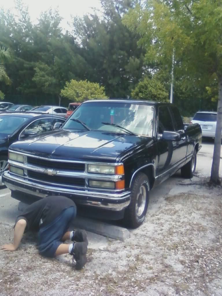

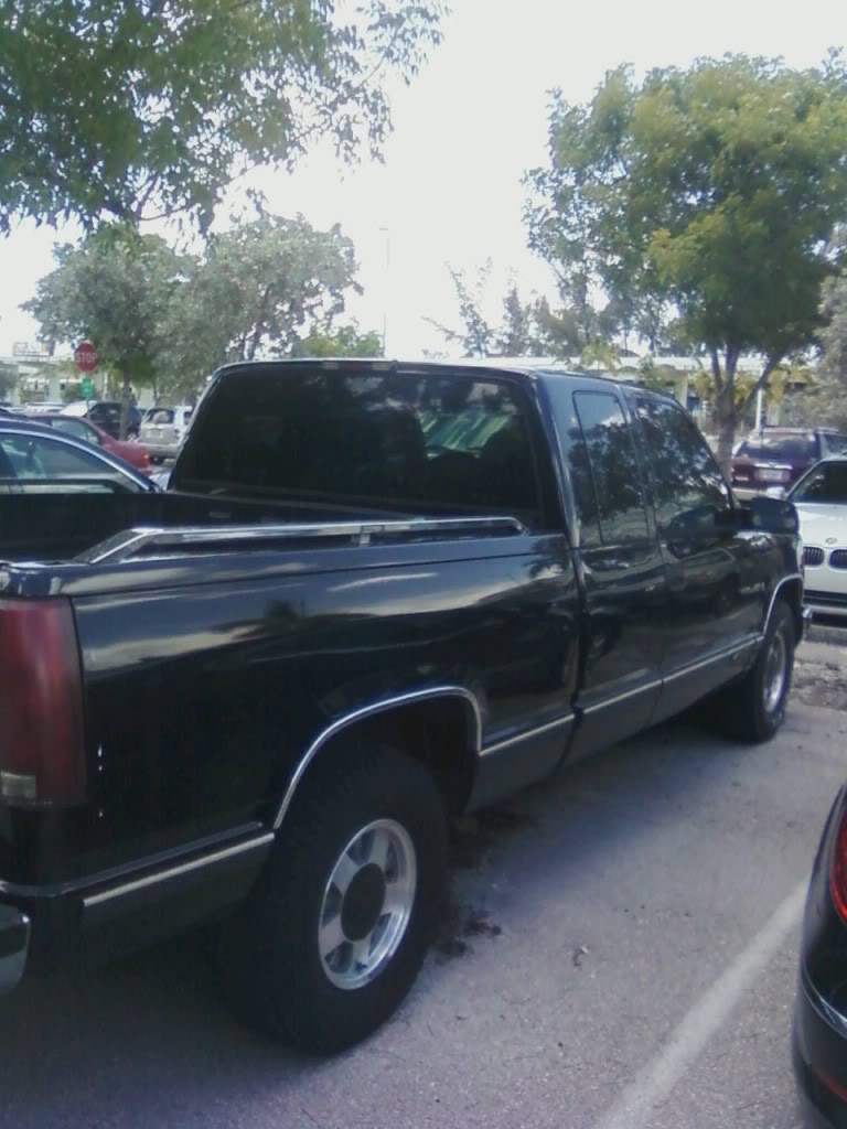

hello to everyone
i just got my first truck. its a 96 chevy c1500, it has a 97 motor in it with 87k miles on it. with recipt.
my questions are:
feels like the truck lacks power and gusels gas like a beast, i drive it like a old lady wat can this be?
the truck chasis have 280k miles, but i got the truck from a good friend and he gave me the recipt for the new motor. the truck has magnaflow exhaust. i deleted the cats on it, cus of one of my dads friends told me that they might be cloged. so i took them off. the gas milege got better, after i took off the cats and i took off the air lid from the air filter. it runs smoother feels like it has more power, but it still not to its potencial my dad had a 97 yukon and that truck used to move.
i did the oil change, fuel filter, oil filter, and sparck plugs. i have the new wires but still havent put them on... any suggestions or info will be apreciated thanks..
here some picks
Attachment 2703
Attachment 2704
Attachment 2705
