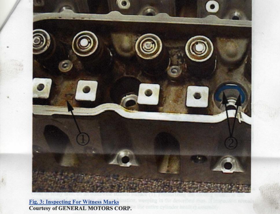

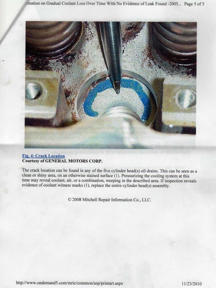

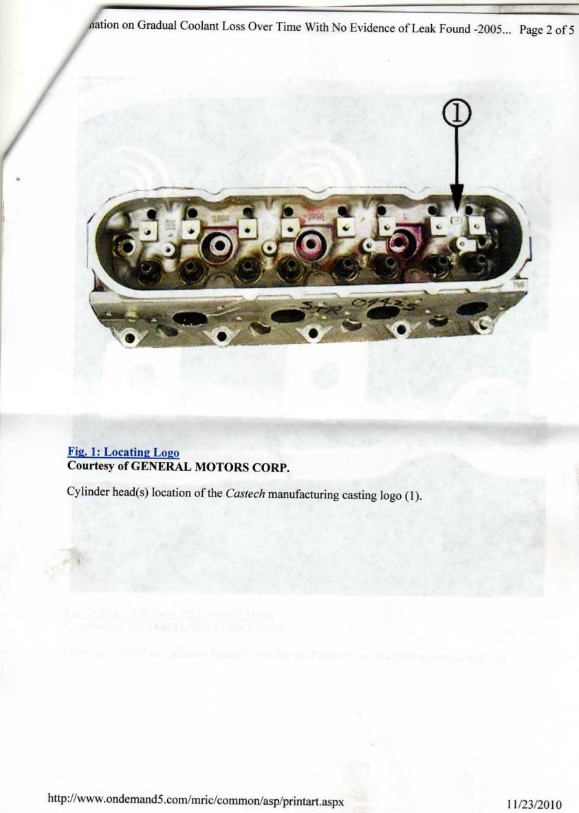

I kinda agree on the over the counter stop leak stuff. That has to be attatching itself to everything like the radiator, heater core, and the throttle body on my truck. My mechanic gave me the service bullitin. They say look for the Castek brand heads. The crack happens at the head bolt. The say if you are getting water in your oil and you have these Castek heads its probaly a cracked head not just a head gasket. If you dont have these heads then its a head gasket.
I will try to scan and attatch the bullitin. The one pics shows where the crack happens in blue.
