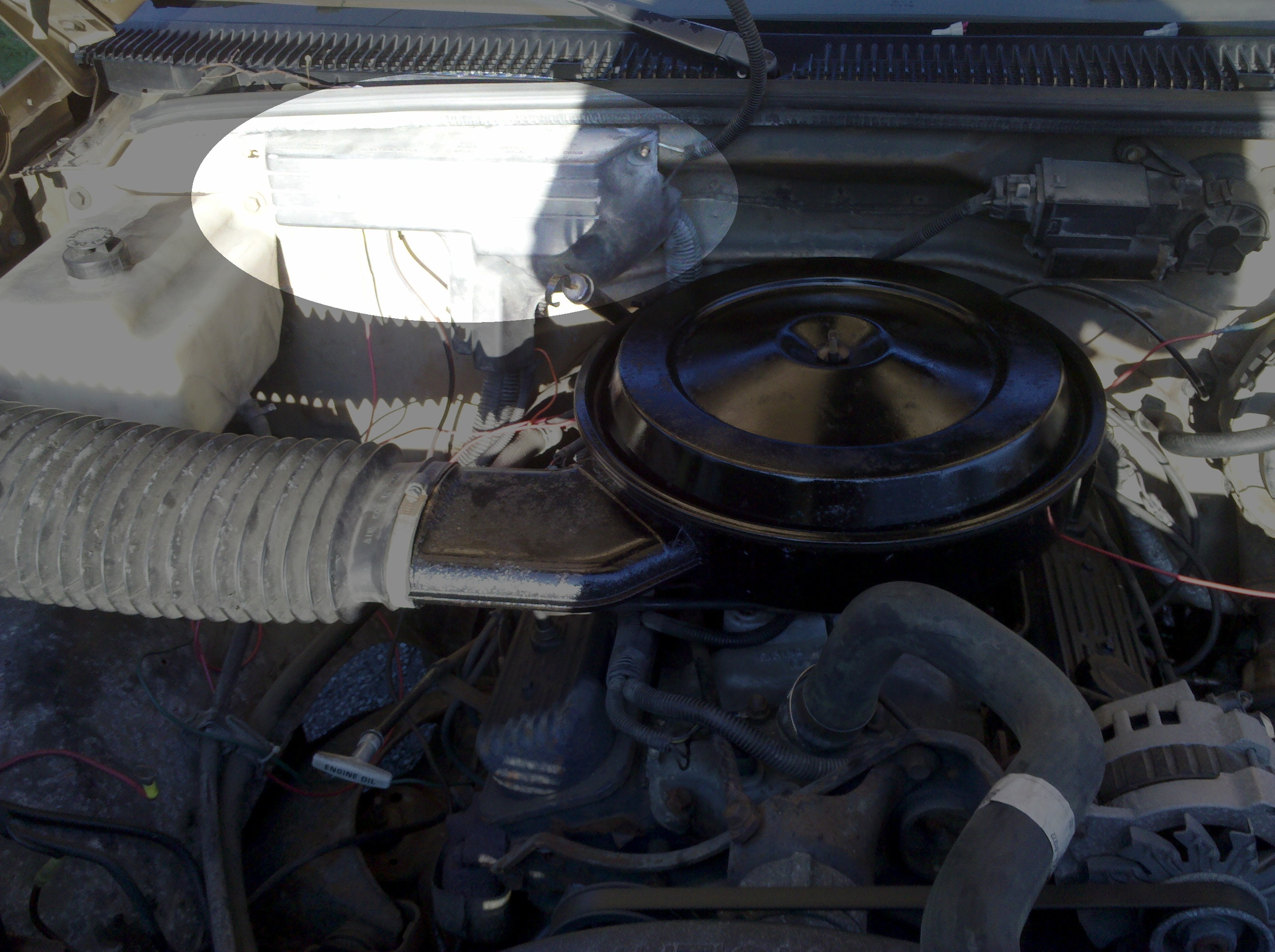

The oil pressure sending unit is part of the injector relay circuit, if I recall.
Looks like you have a fuel pump relay issue.
You should have 12 volts from the ECM on the dk grn-wht wire with the key on and possibly cranking, should have a good ground on the blk-wht wire, 12 volts at the orange wire.
Basically if you jumper the orange wire to the gray wire the fuel pump should run all the time. Sounds like your truck is running off of the oil pressure switch after the engine builds oil pressure, the switch bypasses the relay giving you fuel pressure.
So my guess is you have a problem on the control side of your relay. Check powers and grounds with what I said above and see what's going on.
Did you replace your fuel pump relay already? It's on the firewall behind the cover above your coolant overflow tank.

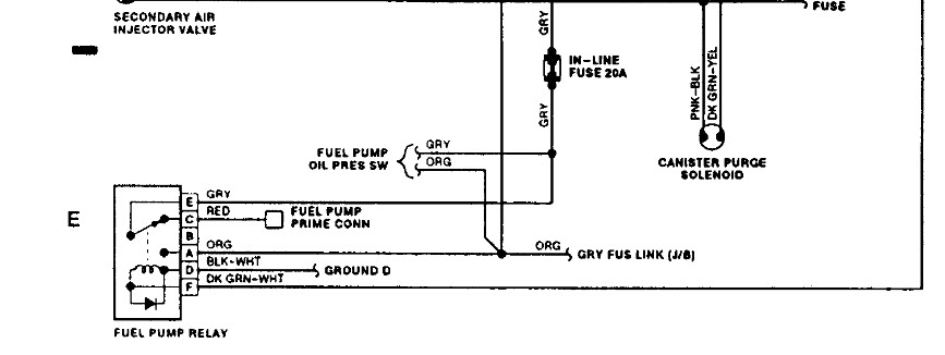

Basically your fuel pump lives off of the gray wire, and the orange wire is the power one. The fuel pump is grounded by the relay through the ECM is what it looks like:
Orange should be hot all the time, the gray wire has the fuel pump on it. The wires I talked about in the other post are the "control" side of the relay. Really, you should be able to do most of your diagnosing from the base of the relay with a test light/volt meter. Just be careful probing around and don't short anything.
