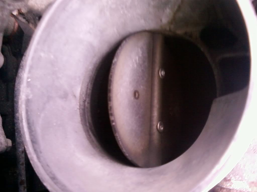

Checked the throttle body and it was very dirty, black inside.
Used a clean rag and some throttle body cleaner and sprayed/wiped it all out inside. Lots of yucky stuff came out. Once it's a bit warmer outside i'll redo and throw a toothbrush inside.
Engine didn't start the best right away but cleared up and idled nicely.
Will find out tomorrow morning when i do a cold start.
here's 2 pic's before i cleaned it up.

If your TB looks like that, then your IAC valve will probably be worse. Taking off the TB and cleaning it would be better. The IAC valve is what chokes it for cold start ups. Try cleaning this thoroughly to see if this helps.

Has anybody messed with the throttle adjustment screw???? The butterfly valve looks like its closed all the way.....sounds like a TPS or IAC to me especialy if it only does it cold

Dont think these TB's have an adjustment screw. The flap does close all the way, so the computer uses the IAC pindle valve to adjust for incoming air for loads or cold start ups. But I agree, the IAC valve has to be gettin stuck or its bad.
