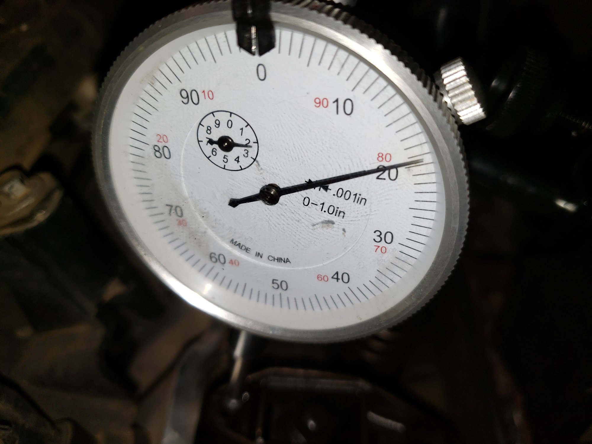

is it possible for the cam phaser to stick and have the valve timing off?
with timing marks lined up, and #1 piston top dead center
the exhaust valve is already starting to open.

on top of exhaust rocker at pushrod 90' before crank lines up timing marks

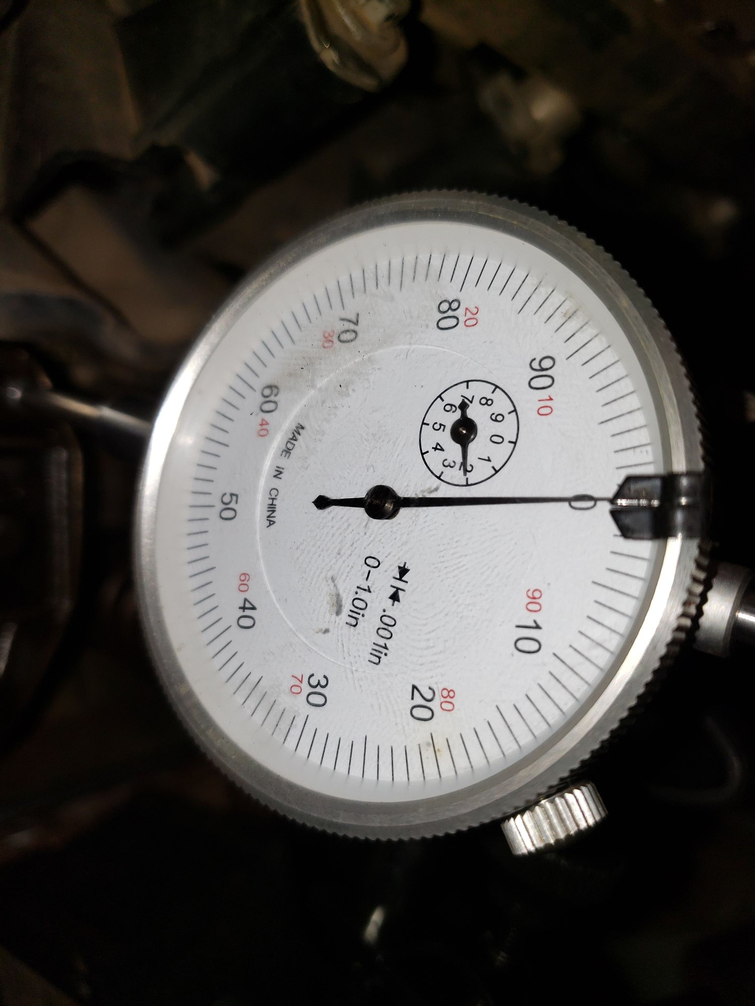

Posts: 17
with timing marks aligned
exhaust valve has started to open

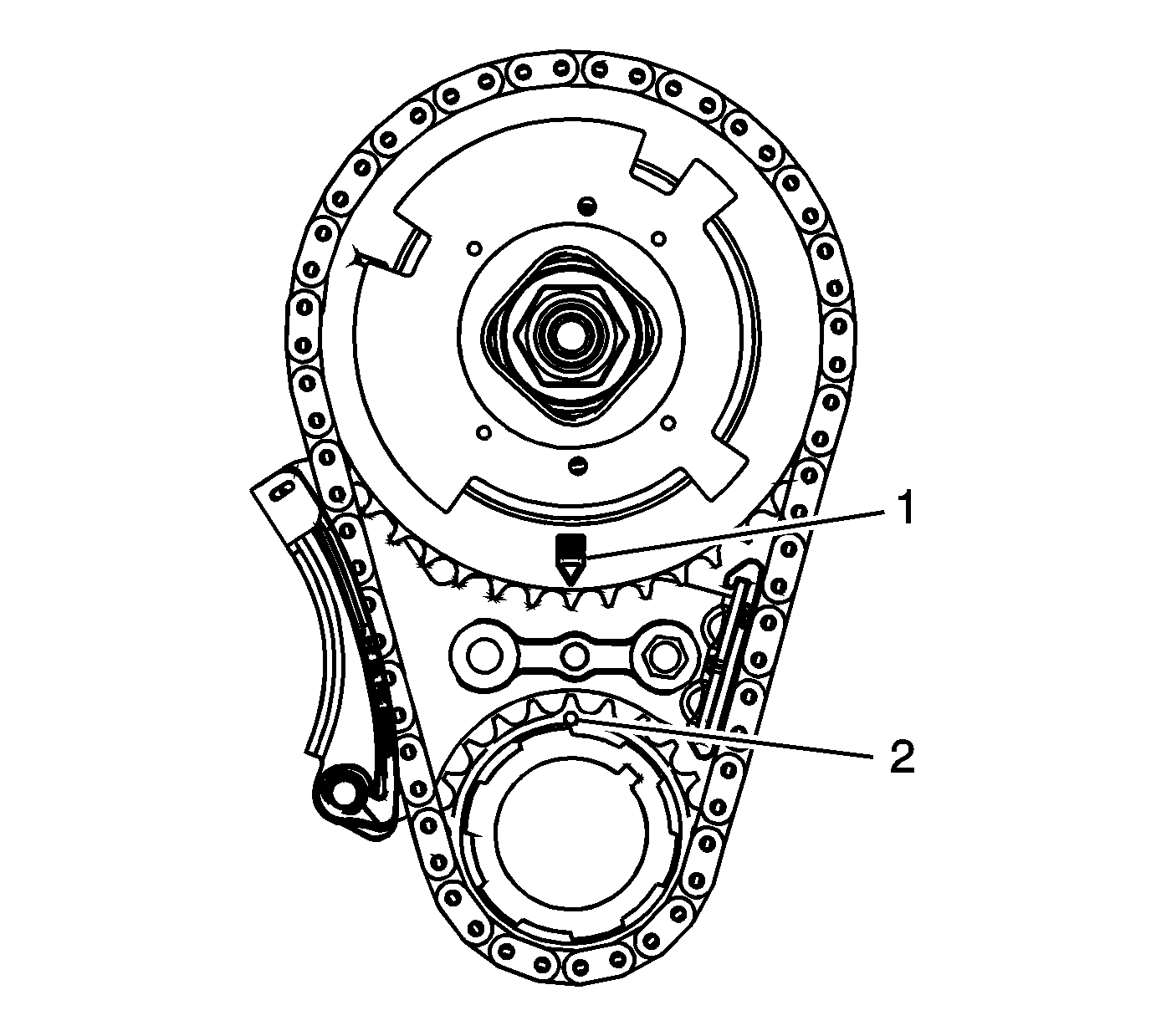

Pin from camshaft broke off in cam gear. allowing cam timing to be off

UPDATE:
GM TSB# PIP5168F
# 19-NA-212
states if cam sprocket locator pin has sheared, replace engine
