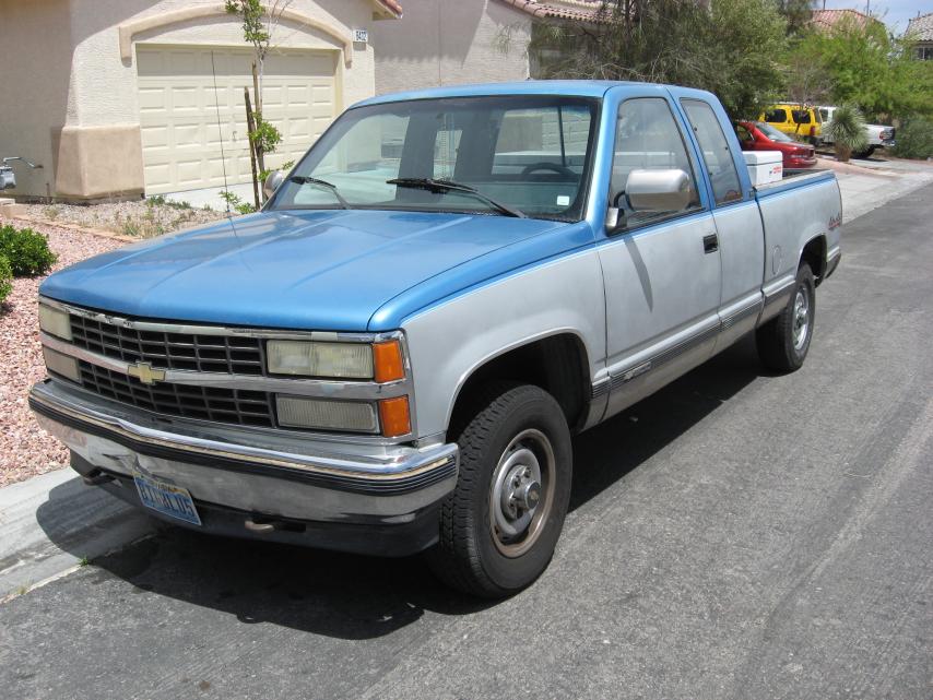

Mr_Shamrock,
SUCCESS! It was the ignition control module the entire time. $40.00 at O'Reilly's and an hour to replace and the trcuk runs beautifully. I could not find a cheap code reader and the auto parts store wanted $300.00 up front to use then they would refund me so i took a gamble based on your advice and voila, works like a charm. Ran her for an hour staight today (It was 108 in Vegas today) and road tested on the highway and it's purrin!
I can't begin to thank you everyone who was kind enough to respond and to Mr_Shamrock in particular, the Luck Of The Irish was on my side today!
Thanks A Million!
Big Vin
PS -- Here's a picture of Big Blu!
