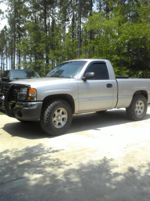

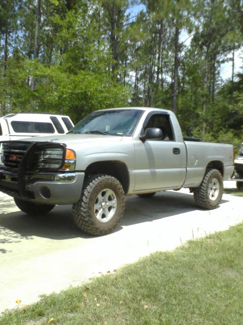

just put one on my 05 sierra, i love it! even rides better since shocks came with it

i got my lift from adrenalinemotorsports.com and they are pretty cheap it is a rough country and i love it, it was only 189 and all four shocks came with it
