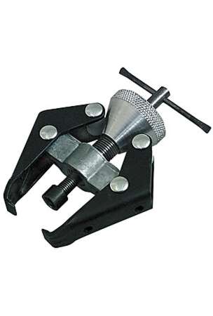

2001 Silverado has a nut on the wiper arm and will need a puller to remove the arm off the splined shaft.

I went to the parts store to get a new arm, figured I'd start there before taking things apart. One of the people in there mentioned they had the same problem a few months ago and all they had to do was tighten the nut holding the arm on. So I tried that, and that did the trick. I did take it apart later, just to check out the splines, etc, they were worn some but not enough to be a problem. So, and I cannot believe I didn't check this first, the tightening of the nut was what did the trick for me.
