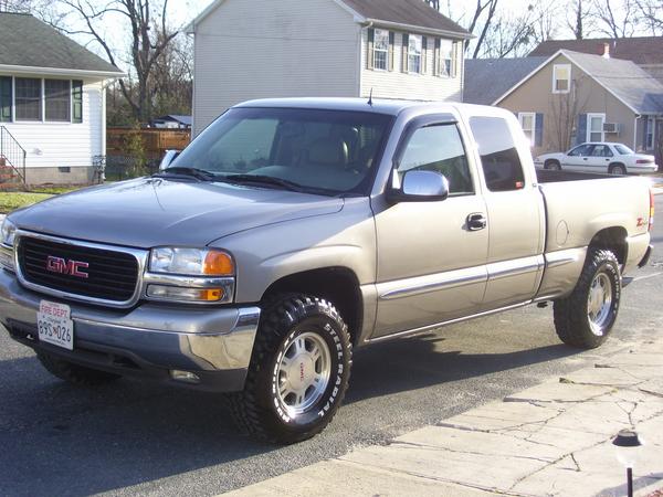

I attached a photo of my truck with the 285's on it just so you can see what it looks like.
WWJD

Thanks for the info, definitely a help and your truck is just a year newer, other than that they are the same so the pic helps out a lot, its nice to be able to visualize it all as well. just a quick question, have you noticed the ride change at all? I've read some places that if you just crank up the adjustments it rides noticeably rougher. i dont mind a harder ride to an extent, but i dont want to be losin parts everytime i catch a pot hole. what did you notice?
