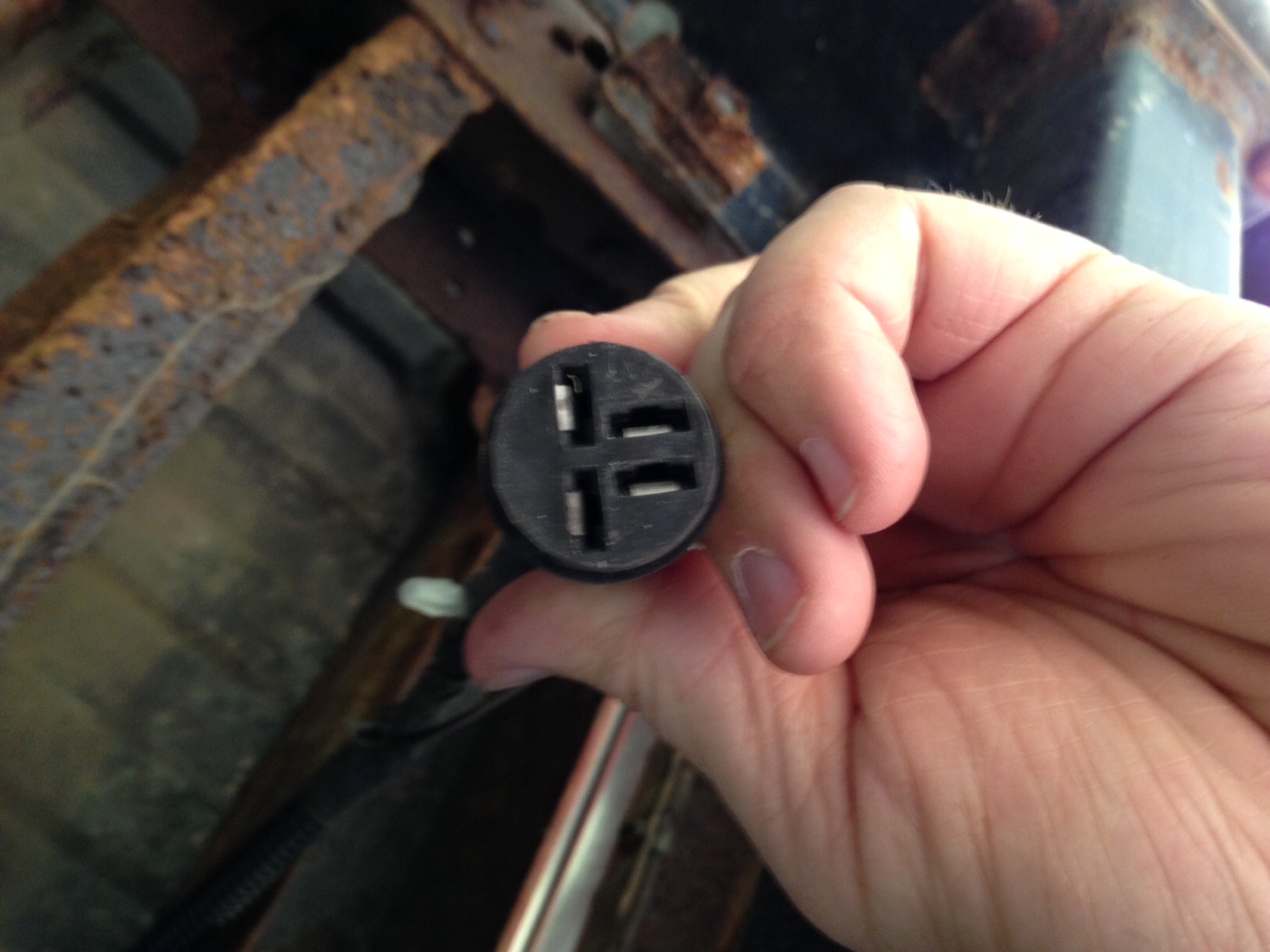

Awhile back I purchased a new rear light harness for my 85 k10 truck since the previous owners did a wonderful hack job on the wiring adding accessories. I purchased the harness from LMC and everything lined up and fit great with only one issue to deal with. The original plugs had been replaced by new ones on the truck and the new rear harness that was installed will not plug into the truck. Also the new harness has 6 wires coming out of the plug instead of 4. The plug on the new harness is a female plug with 4 pins. Has anyone used this rear light harness from LMC or know where to get a replacement connector for this harness or any information on if I have to hard wire it in how to splice the original 4 wires on the truck to the 6 wires on the harness? I have included a picture of the connector that is on the harness that was installed. I need a 4 wire connector that will plug into it.
