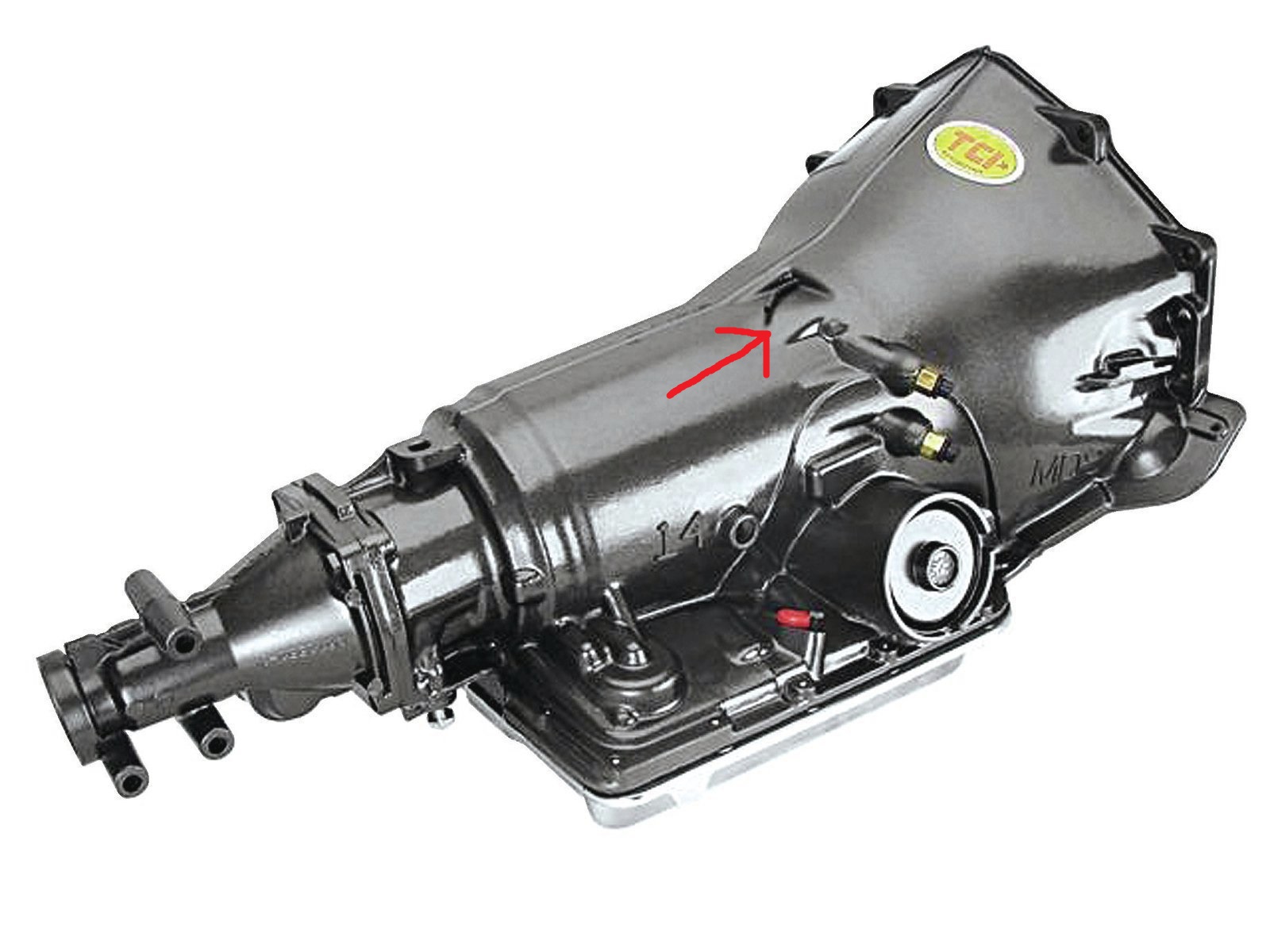

Yep, the whole seal popped out. I am starting to think it has been damaged a while. I replaced the transmission mount underneath that seal a year or so again. Transmission would have pushing the driveshaft down on that seal pretty hard before I replaced the seal. Just a thought. Where is the vent at? I would like to check that.
I replaced the seal and refilled the fluid (took 6 qts). I was able to drive it around the neighborhood but I have not given it a real test yet. It is making a noise that sounds like its from the front of the transmission that sounds like metal plates scraping together. The noise increases and decreases based on speed. Not too optimistic, but at least it moves now. Thats a start.
Normally when the trans is opened up and being worked on, you'd want to blow that out with a compressed air. Considering you have parts inside your trans still, you'd blow the blockage back into the transmission ... So at this point, I'd say f*ck it, she's noisy anyways, blow the sucker out and hope for the best. Maybe pull the pan and look for debris. Unless you blew up ALLOT of hard parts inside the trans, and it wouldn't move anywhere anyways, there's really no way for that seal to by physically "pushed" out unless the pressure buildup from the blocked vent is what did it. And the fluid you found on the intake, I'm assuming is black trans fluid. That's clutch material that's worn off of the clutch disks. That's really the only reason it turns black.
That being said, a bottle of Lucas transfix wont hurt a darn thing. Pour in $12 worth of "keep me rolling" in a bottle and hope for the best. It doesn't sound good for that trans. Lets just hope the noise you hear is a bad bearing or a clutch pack gone metal on metal.
But if you do end up needing a rebuild, I highly recommend you put in a new beast sunshell. Just sayin', there's almost no reason to NOT put one in. The part will be in your hands, and if hasn't failed yet, it will. Spend the extra cash and put in a stronger sunshell and you'll thank yourself later.
