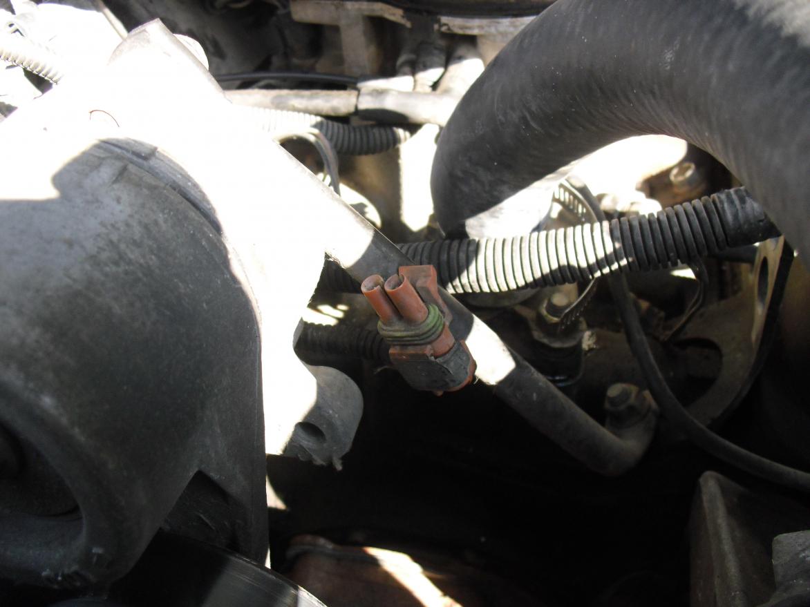

mhmmm. Me and my Dad took a look under the hood and there is one wire not plugged into anything. When I change the air filter tomorrow I'll post some pics.

Here is a image of the wire.

From: Detroit, MI
Hmm I have no clue what that wire is. Doesn't look like anything that's on my truck. Maybe the A/C compressor clutch wires?

mhmmm. Thinking the engine might not be stock....so any one know what the heat gauge issue could be?
