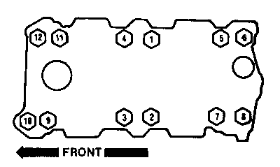

Intake Manifold gasket torque sequence:
Torque to 35ft. lbs
\Torque to 35ft. lbs
