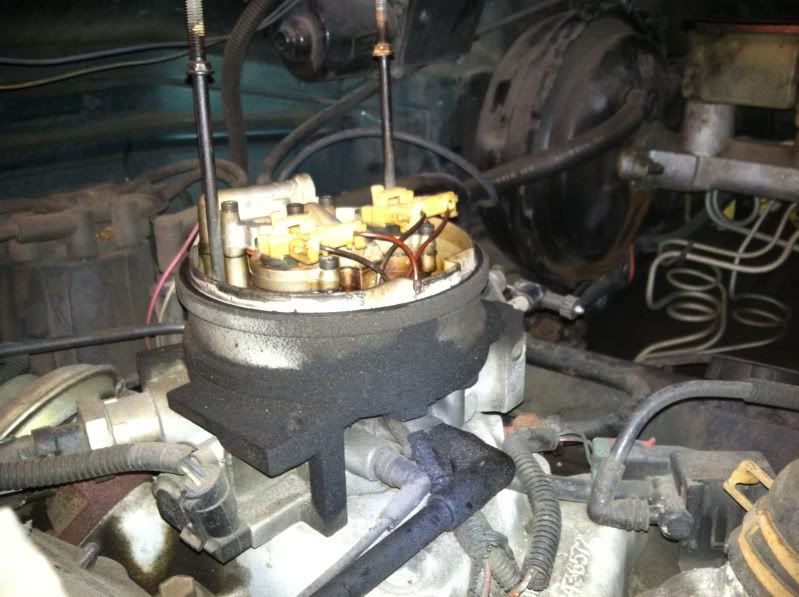

no codes, no engine light, just passed smog today (yay!) ...cleaned grounds, replaced plugs,replaced fuel filter, added sea foam to fuel, new oil...cleaned carb with carb cleaner, runs a bit better but still has slow crank/start...will pull starter and have checked next weekend, gonna look for one at junk yard and rebuild it...see what happens. also gonna check fuel pressure after i order the inline adapter unless anyone know another way
oh, another thing, after taking off air cleaner i noticed that the throttle body looks like this, is it leaking/cracked or? is this normal? thanks
http://i29.photobucket.com/albums/c2...8/IMG_2411.jpg
You might consider pulling off the throttle body and rebuild it. That TB is really gunked up! It should look like the one in the pictures in my thread here: https://www.truckforums.com/forum/ch...ressure-18272/
That's also my write up on how to check your fuel pressure.
Also, from the picture, looks like your master break cylinder is leaking. See the rust streaks down the front of the booster? and it appears as though your reservoir is a little low too. Just an observation.
