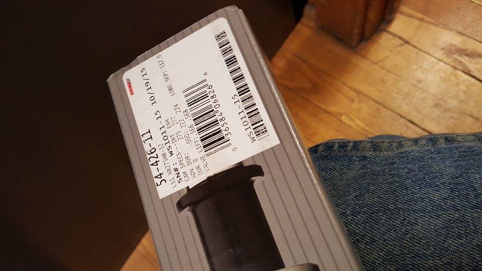

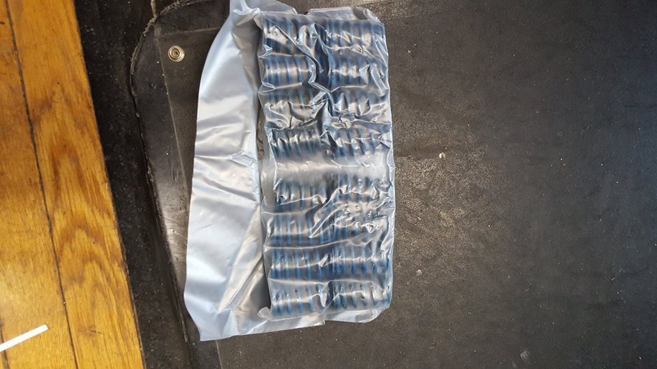

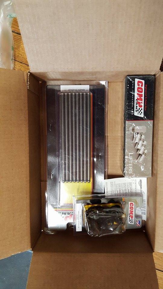

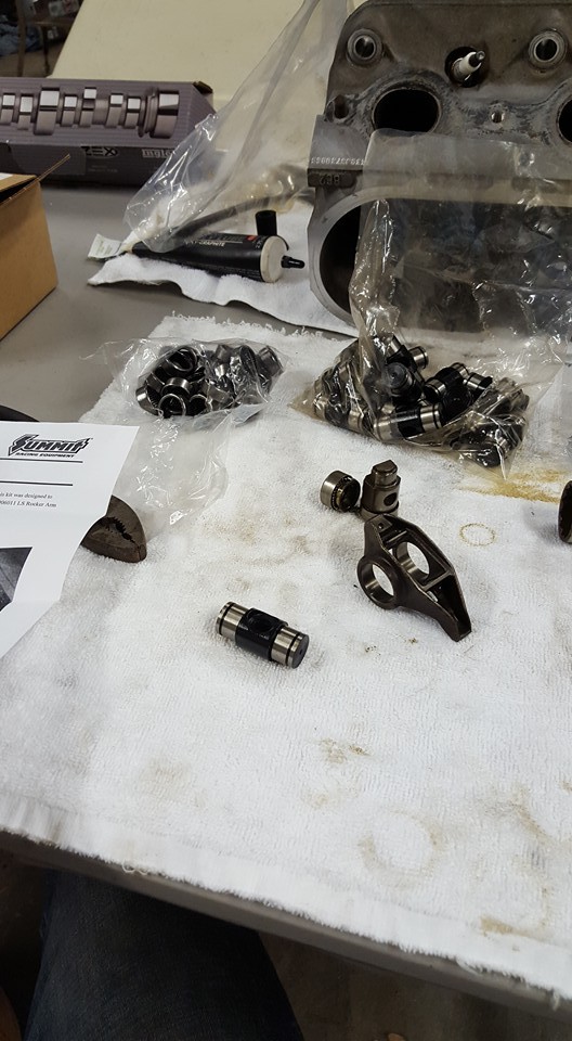

My choices for the top end were simplistic. My cam is a Comp Cam grind 54-246-11 ($349.88) 222/224 @.05, .566/.568, 112 LSA. Its about all the further I would go with the weight of the truck. This cam is recommended to have springs with a rate of around 313lbs, so I found some beehive spring from GM that rate 332lbs. NAL-12499224 ($59.09) These springs are only rated for max lift of .570, but I've tested their coil bind before, they should be fine for this cam. For lift transfer I opted for keeping the original rockers, but adding a Summit Trunnion kit. SME-143002 ($99.97) For pushrod assurance, some Brian Tooley Racing 7.4" rods. PR7400312-16 ($99.00). I'm not sure if it is a requirement yet, but I got some new retainers for the springs as well. Comp 787-16 ($55.99). I plan to leave the head castings as they are. I don't have the long burrs to perform a true porting job, however I can port match. I will be porting the intake manifold, and smoothing the exterior of it. I got stainless longtube headers and y-pipe to let it breathe on the exhaust side too. A cheap find from Auto Dynasty ($312.00). Some reviews show that they require bending to fit properly, but I have access to more than enough tools to accomplish this. $300 compared to $900+ for name brand. Budget is my goal after all. Once all is said and done, I will send the ECU to Texas Speed for a mail order tune so I can drive it to a dyno in VA. ($250.00)

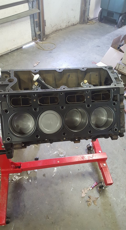

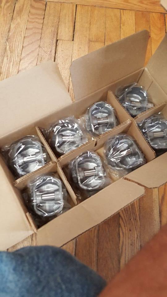

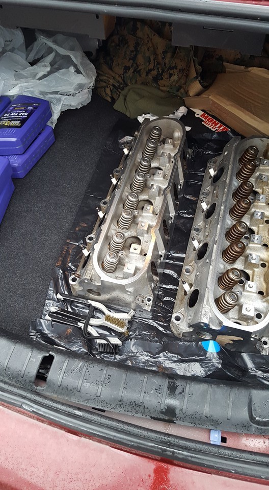

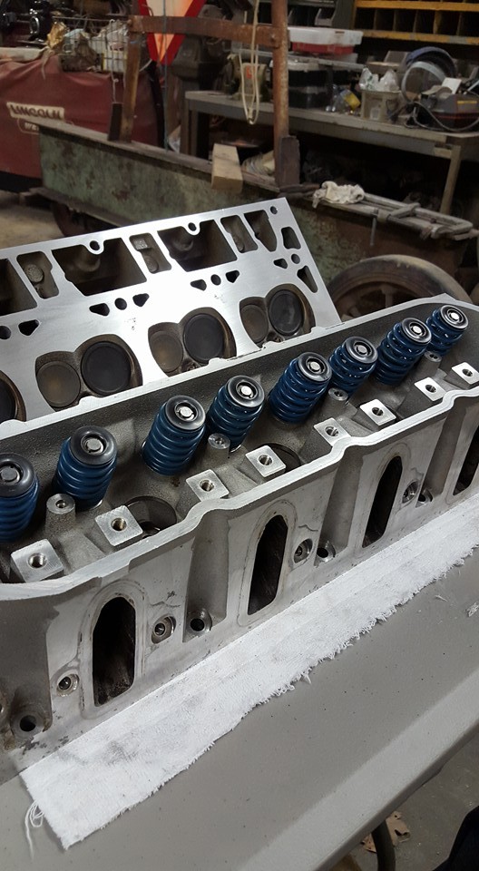

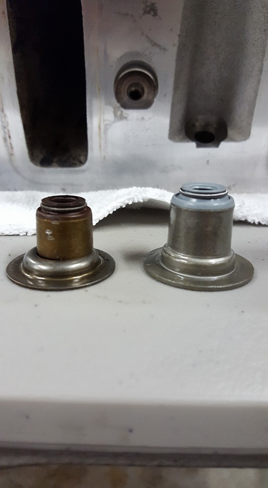

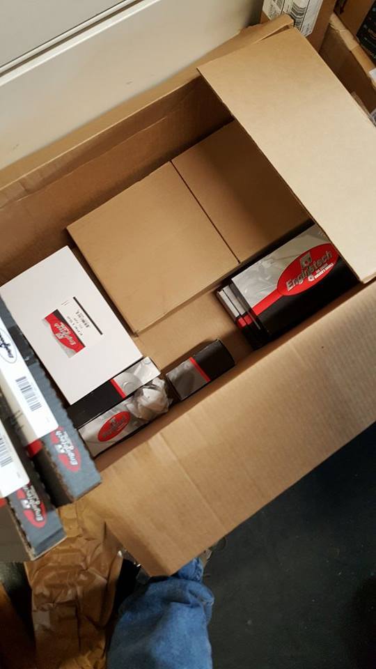

My bad. Hopefully this works. Some parts viewed might be for my brothers gen1 350 I'm building at the same time. He's not good at sending me pics. I also just ordered some 8.1L injectors to help with the cam on the high end.

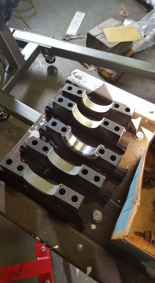

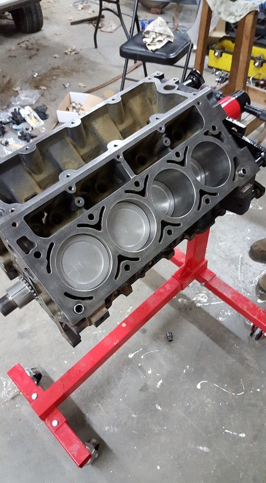

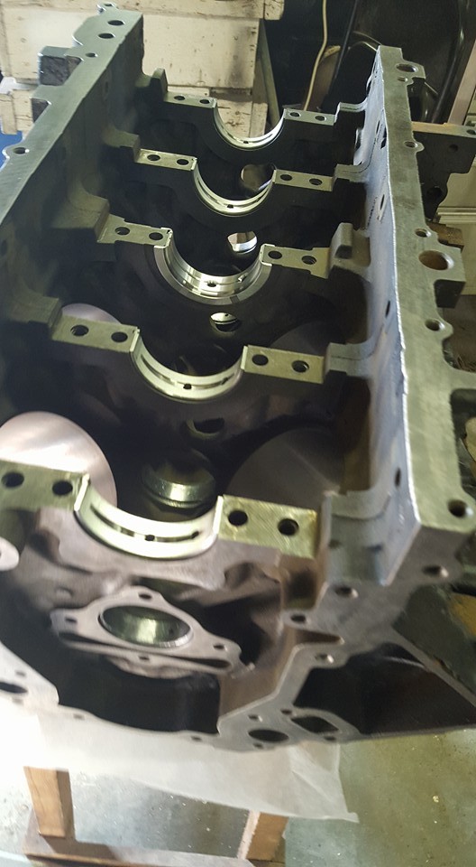

Old Dec 11, 2015 | 08:03 PM
Dansic's Avatar
Joined: Oct 2011
Posts: 26

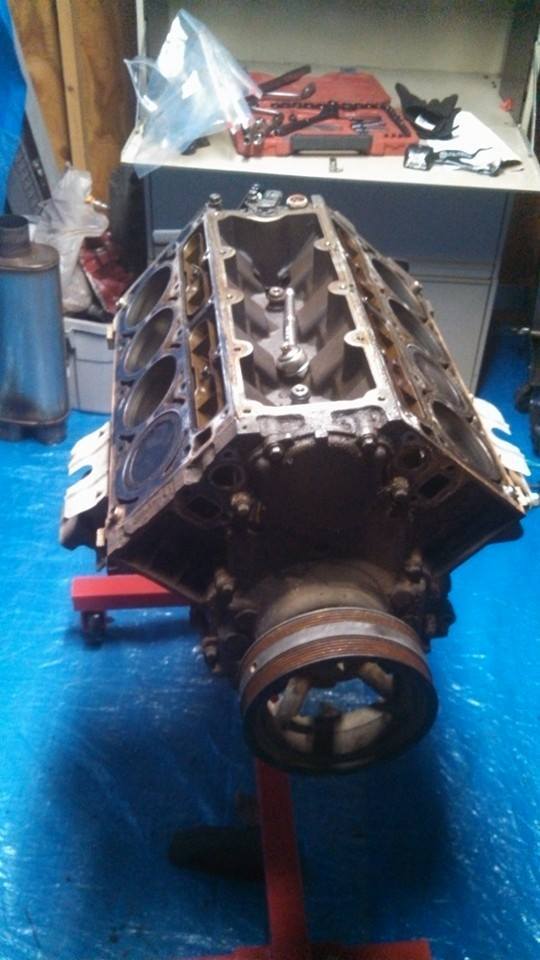

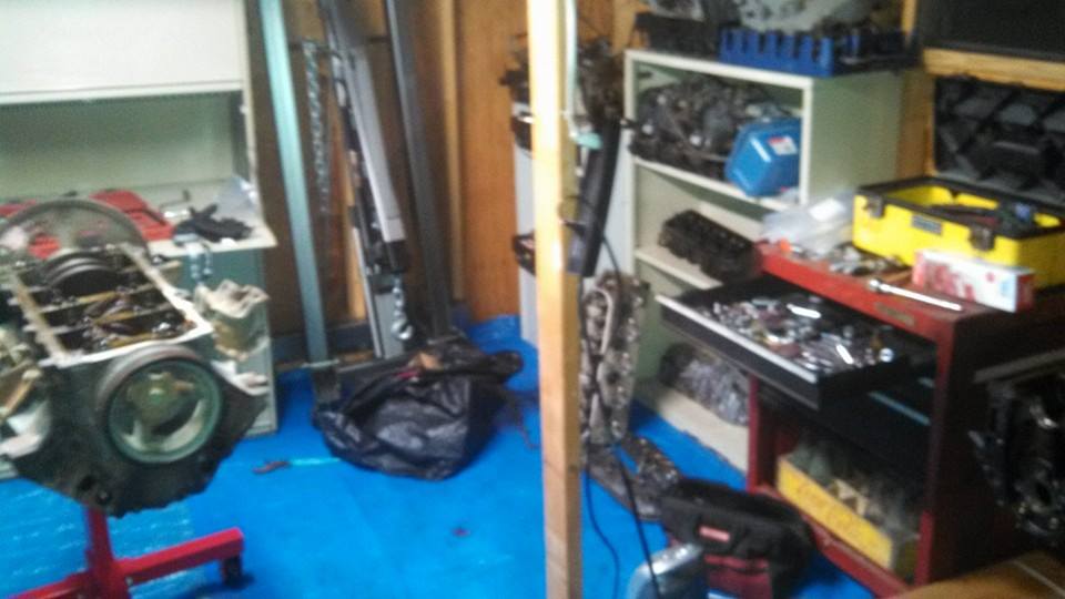

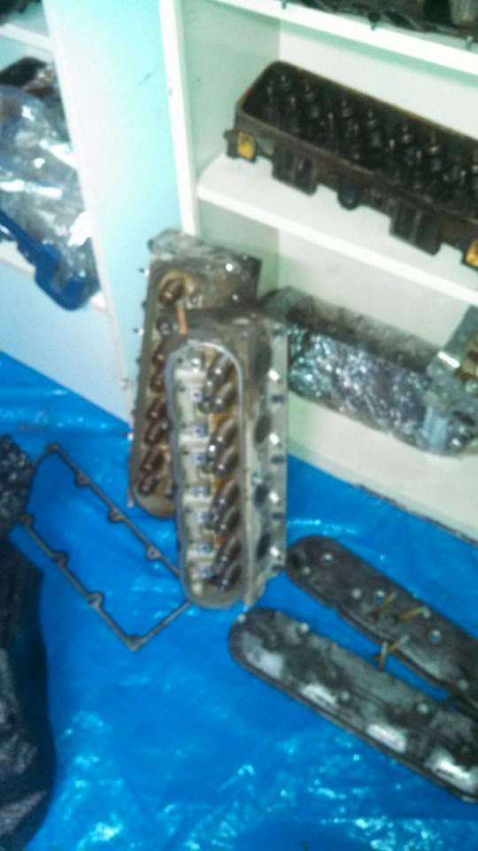

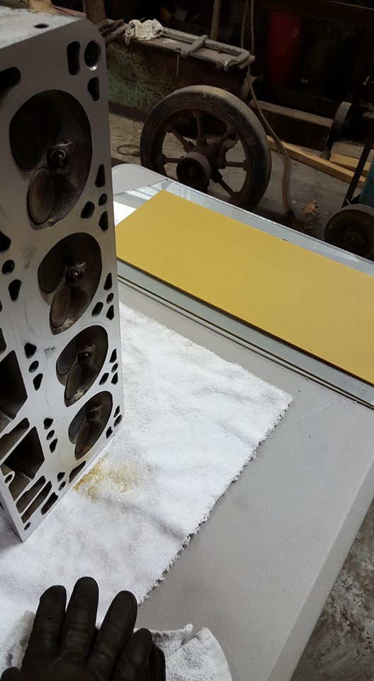

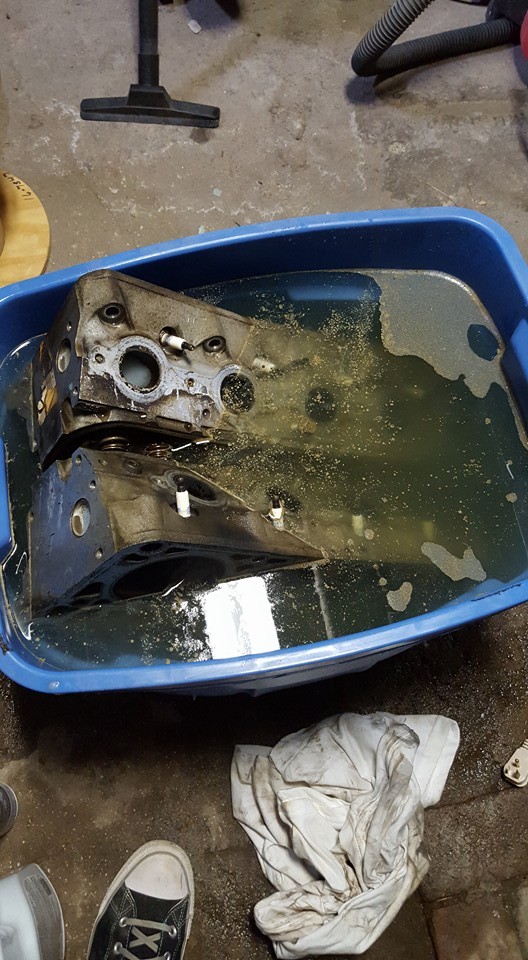

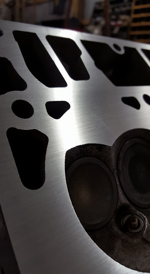

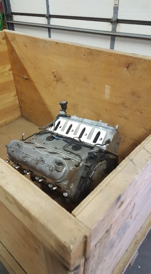

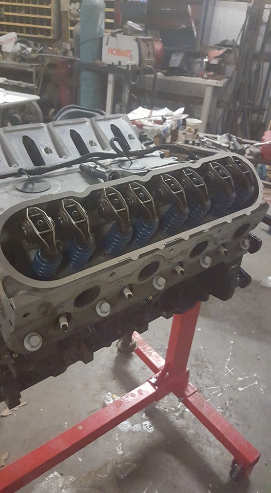

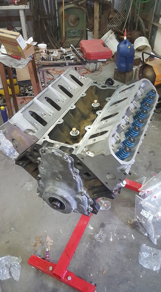

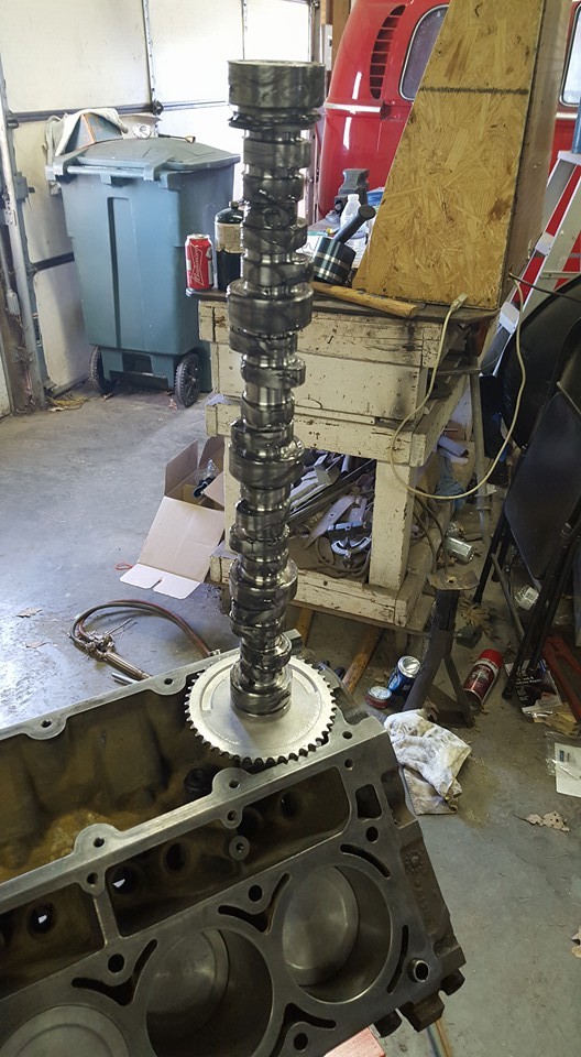

I wasn't able to put the engine in over my 30 days at home. The machine shop took 23 days to get it back to me just to bore, hone, and put the new cam bearings in. Super pissed. But I'm going back for another 12 days on leave for Christmas. I will continue starting the 18th! Until then I crated it and everything else. I've done everything besides the boring and cam bearings myself. Even surfacing the heads and lapping the valves. I used a slab of glass and sand paper to surface the heads, and just some lapping compound on the valves.
