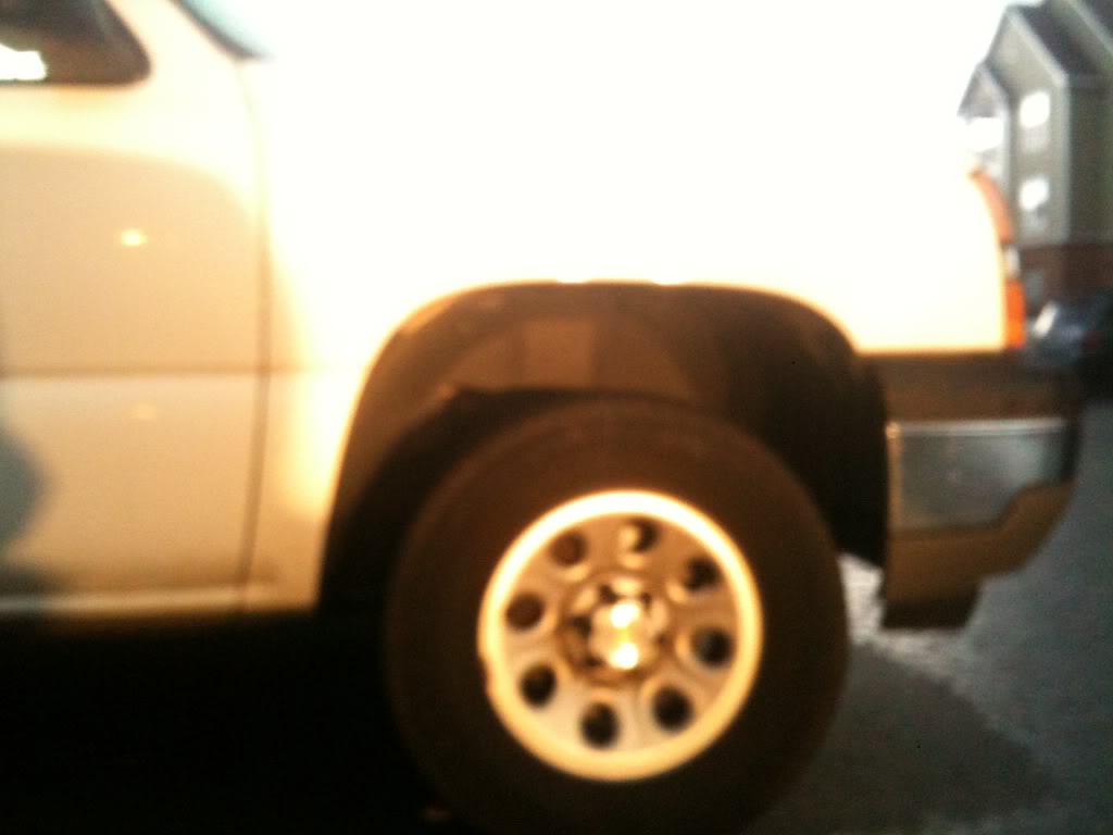

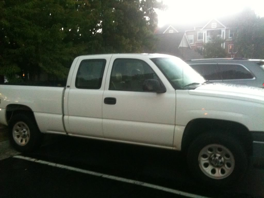

Old Aug 29, 2011 | 09:01 PM
dukesbb37's Avatar
Joined: May 2011
Posts: 16
not sure how much it lifted the front... but i measured the front and back and it was 94cm in the front and 95cm in the back so its almost level
Old Aug 30, 2011 | 11:08 AM
Mr_Shamrock's Avatar
Joined: Apr 2009
Posts: 2,267
How many turns did you give it? Looks good! How does it ride?
