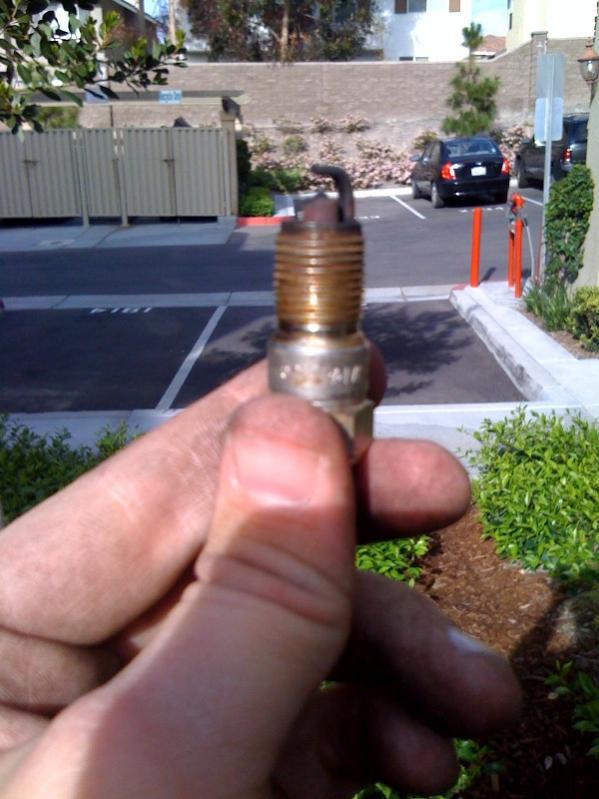

Okay.. So I pulled a plug (2nd one back on the drivers side). It looked okay I guess (photo attached)... I screwed in the compression tester and got about 170ish so It is working properly.. I put the plug in the wire, grounded it and cranked the engine over and was getting spark (orange spark?). So it is getting FIRE!

A fouled plug will be very black or covered in fuel. A "bad" plug could have a few different issues like a broken or cracked tip. Yours are slightly black, but I don't think enough to be fouled. The perfect burning plug should be a nice clean tan color.
