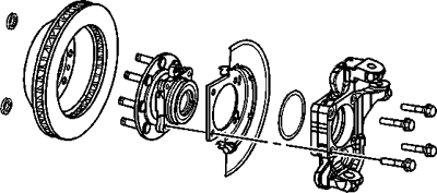

Really it's not as bad as you make it out to be. The bearings on my van lasted over 100K miles. That's pretty darn good if you ask me! For your truck, it's easier to replace the bearing than was on my van. Here is the procedure:
Torque the hub and brake bracket bolts to 133ftlbs
You'll only need to replace or service this bearing if 1) the bearing has vertical play in it (You can shake the wheel and hub up and down by grabbing the top and bottom of the tire), or 2) it starts making lots of noise. Otherwise, there is no maintenance to these bearings. They will last a very long time.
