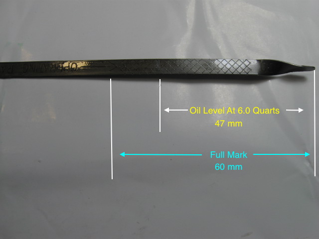

I have a 2000 Sierra with a 6.0 liter engine. The owner's manual calls for 6 quarts of motor oil. In the past, I've had the oil changed at a local mechanic's shop & at the dealership. When the technicians are finished sometimes the oil level is below the "Full" mark & sometimes it is at the mark.
I've read that some of these trucks' dip sticks don't read properly or are the wrong ones, so I asked at a dealership. The person verified that I have the correct stick and also said they are known to read wrong, but had no idea where it's supposed to read. He said they add 6 quarts & are done.
This week, I changed my oil & filter myself. I got the engine hot & let drain for about 4 hours with the filter off (while I cleaned &/or replaced Zerk fittings). I even raised the front a bit to be sure the oil was drained completely & nothing dripped from the drain or filter connection.
I installed 6 quarts without spilling any oil. After running it for a few minutes and then letting it sit overnight with the truck level, the oil level is below the top of the dip stick's cross hatched section (the "Full" mark).
The oil level exactly 47 mm from the end of the dip stick. Full is 60mm from the end. (Photo Attached) That indicates the oil level is ca. 78% of the way to the 'Full' mark.
Do any of you know where the oil level is really supposed to be on this stick?
If I add oil to bring it to the "Full" mark, am I going to damage the engine? (It looks like 7 ounces will bring it to 'Full".)
If I leave it at 6 quarts, will that damage the engine?
Thanks for your advice! I appreciate the guidance.

I wouldn't even think twice about adding the necessary oil to satisfy the dipstick reading. I've seen people with as much as two extra quarts of oil in their engine (yes, that's 8 quarts) and not experience any issues.
So if it were mine, and I was changing the oil myself. I would buy 6 quarts and call it a Tuesday. If I was getting my oil changed, or was at the shop using their bulk oil which can add fractions of quarts easily, then I would top it off.
Either way, I wouldn't concern myself. If a topped off dipstick makes you feel good, then top 'er off
Thanks very much for your help & advice NullHead. I appreciate the words of wisdom.
I'll leave it at 6 quarts. The engine uses a just tiny bit of oil between changes, sometimes none, so it isn't likely I'll be buying another quart before the next change.
I marked the dip stick with a punched line where 6 quart filled to, so I'll have a reference to check the level against.
