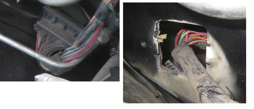

My wiring does not correspond with the schematics in the Chilton Manual for my truck. My '90 GMC 1500 C originally came with a V6 and standard tranny but they were swapped out by a previous owner.
I assume that the harness and engine came from the same vehicle. Where the harness go through the firewall on the passenger side it was originally through a hole of about 2.5" X 2.5" but the grommet on the wiring harness was about 2.5" X 4", see pic below.
Any ideas how to identify the wiring harness? I tried to ID the engine but it appears to be a crate engine as it does not have the complete block code.
I have a electrical drain that is difficult and so a schematic will help a lot. I am in the Desert and am not to happy about long hours tracing wires in three digit heat without a schematic.

Hmm .. unfortunately, I really don't know how to ID that harness. I'd say that it will be EXTREMELY difficult to figure out unless you can find out what vehicle that harness came from .. even different years can change the harness somewhat. Or an A/C equipped truck versus a non A/C work truck etc. Do you know what circuit is causing the drain? Put your amp meter between the negative battery cable and the battery post, and watch the meter. Pull fuses until you see your parasitic draw drop (with the key off, door switch taped closed so the lights don't come on etc). Be careful with this ... something you do all the time, such as opening your door with your meter connected can blow your fuse. So I'd suggest taping the door switch closed so the lights stay off, key off, and unplug your under hood light.
