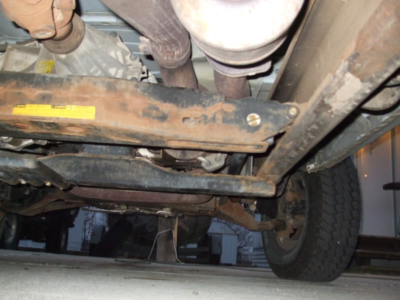

here are some pictures of the exaust, it was starting to get dark on me so i couldent get very good pictures, also laying on my back under the truck does not make for good picture taking...lol

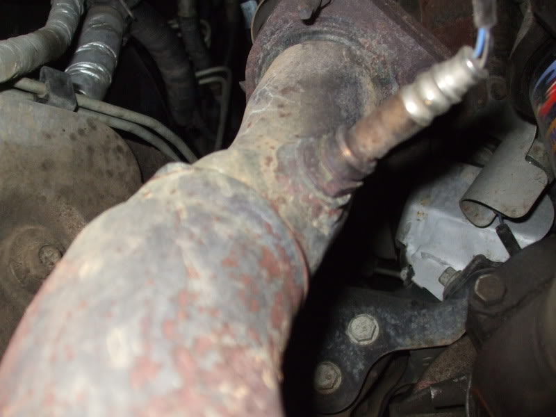

this is a picture of where the exaust is welded on just past the manifold, both sides look the same only took a picture of the drivers side

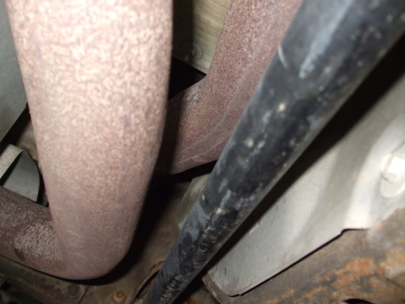

two separate pipes from both manifolds that do not connect until the muffler.

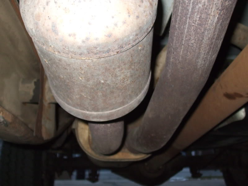

one catalytic converter for each pipe they are offset you can only see one of them in this picture. you can also see where the two pipes go into the muffler

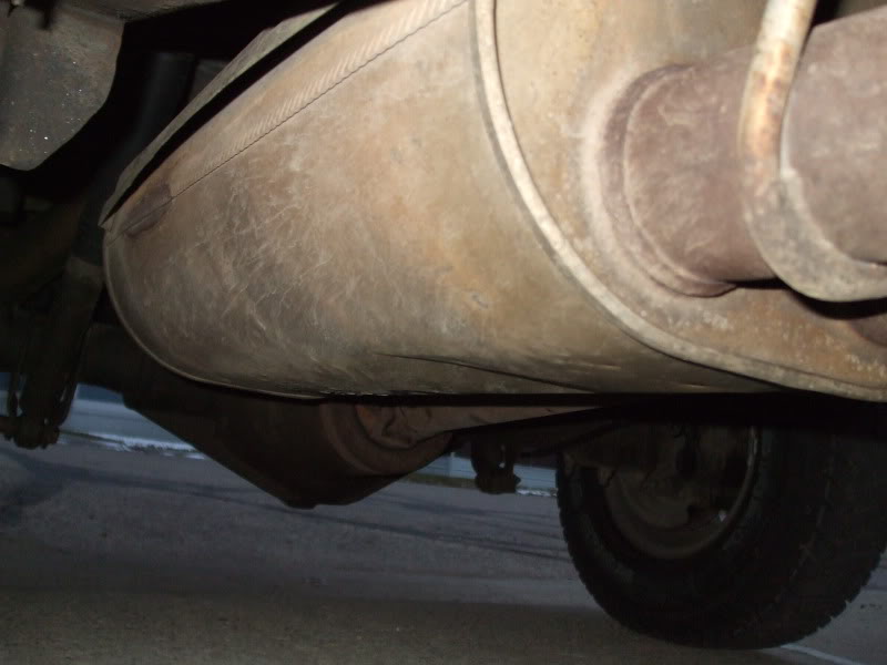

here is a picture of the muffler

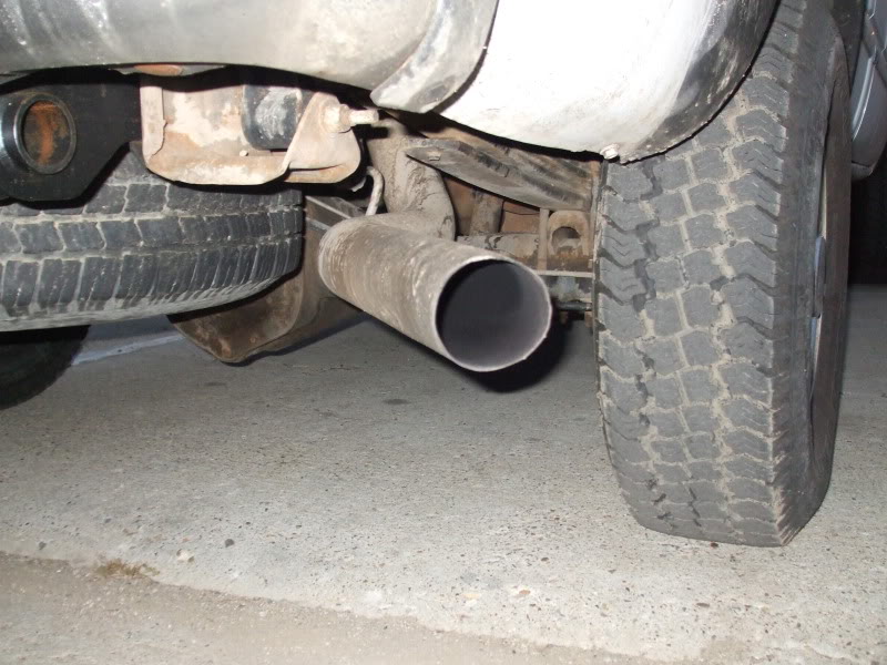

single outlet from the muffler
this is on a 8.1L 496 3 inch pipe from the manifolds to the tail pipe, not sure if it is stock or not maybe you guys could tell me, looks like it would be stupid easy to dual out. don't want loud but a little grumble would be nice.

Yeah it looks stock to me. Looks like my cousins 6 liter. I would cut out the stock muffler out and replace it with 2 mufflers (your chioce) side by side and dualed out either out the rear somehow or possibly dump it past the axle.

Does that muffler actually exit out the rear dualed and then into a sinlge tailpipe? If it does you can cut the single tailpipe off and run it dualed that away. I asl if the muffler is that way, because my parents Avalanche is like that and my friends Denalli is too. On the Denalli we cut off the tailpipe where it went exits as a dual and goes into the single tailpipe and run the duals. The denalli ran better, but the Flowmasters we installed later as a dual set up was a much better improvement. The Flows where welded side by side.
