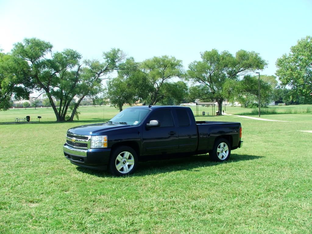

Here is what my truck looks like now.
http://i198.photobucket.com/albums/a...verado27-2.jpg
http://i198.photobucket.com/albums/a...ilverado14.jpg

The way it sits right now is on stock tires, I went with the McGaughys kit, I used spindles up front and replaced the springs and shackles in the rear. I bought the 4/6 kit which comes with the spindles and springs up front and leaf springs and shackles for the back,and rear replacement shocks. (you don't have to change your rear shocks at3/5 and it rides fine.) I paid a little over $900 for that kit, you could do the flip kit in the rear and spindles up front and save some money, if you don't mind your axle being a little closer to the frame.
I have no negative issues at the 3/5. I drove it to Oklahoma City and back twice, once when it was 5/7 and once when it was 3/5. When it was 5/7 my back was hurting when I got home, at 3/5 it rides like it did stock. Drove at 80 all the way there and back with no problem.
It looks good lower, but form really does follow function.For what I need it to do, it was just not functional at 5/7. ( I say 5/7 because with the spindles and springs up front it was 5 inches lower up front and when I changed the leafs and shackles in the back, and removed the 1.25 inch block off the axle it was 7 inches lower in the back.)
As far as installation difficulty, it wasn't too bad, but you will need help from a friend. NOTE : do not disconnect both leaf springs at the same time. As a precaution, you may want to disconnect your drive shaft from the rear end and support the front of the pumpkin with a jack stand.
The hardest thing was lowering the gas tank to get the forward left bolt out that holds the left leaf spring. Next would becutting thebump stops off the frame. (the metal part) If you flip the rear you wouldn't have to remove the forward left bolt, just the rear ones.
