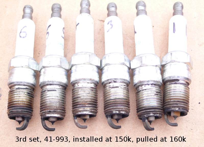

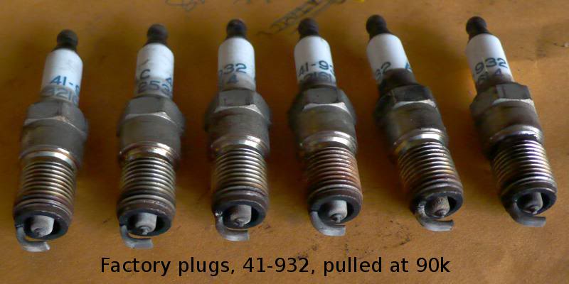

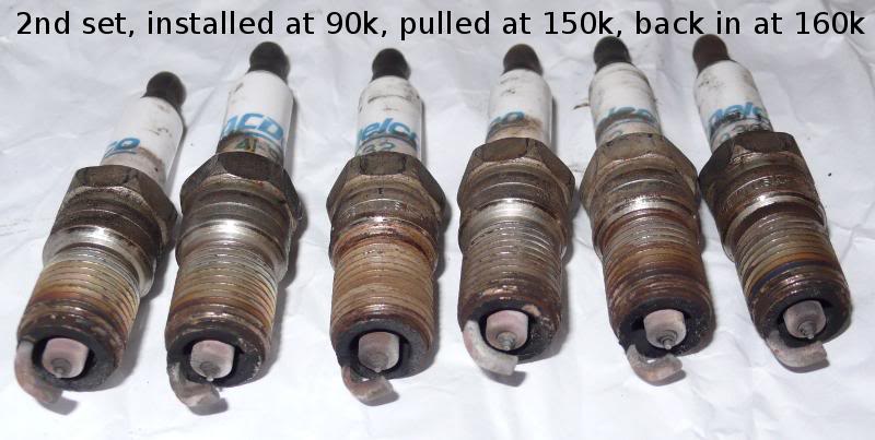

4.3L Silverado had been idling a tiny bit rough for a year or so, so a few months ago, at 150k, i changed plugs/cap/rotor/PCV/AirFilter/FuelFilter. Pulled the 41-932 plugs. Installed a set of 41-993, their replacements, since 932s are no longer being made. Didn't help the idle. Mileage dropped. When i finally decided three weeks ago to track the mileage, it got 320 miles on 23 gallons, just under 14 mpg. Twice, on to fill-ups. Using a locking gas cap.
Since no codes were being triggered, I figured the drop in MPG was due to a gas leak somewhere, though never smelled gas and the connections at the new fuel filter were dry during idle. (fwiw, also replaced a dead fuel pump about 6 months ago) Last month, a parts store clerk suggested the drop in MPG was due to the plugs. I said "always ACDelco". They shrugged. Well last week I reinstalled the 932s. BAMMM! 390 miles on 20 gallons. 19+ mpg. Back to normal.
When new, both the 993 and 932s had been gapped by me at 060. After 60k the 932s measure just a trace wider, indicating negligible electrode erosion. The diameter of the white insulators are identical, so the boots fit equally snug.
Only other tune was at 90k, where the factory 932s were pulled and a fresh set of 932s installed (plus new cap/rotor/...)
maybe the 41-993 need a different gap?

3 Attachment(s)
Attachment 2127
Attachment 2128
Attachment 2129
