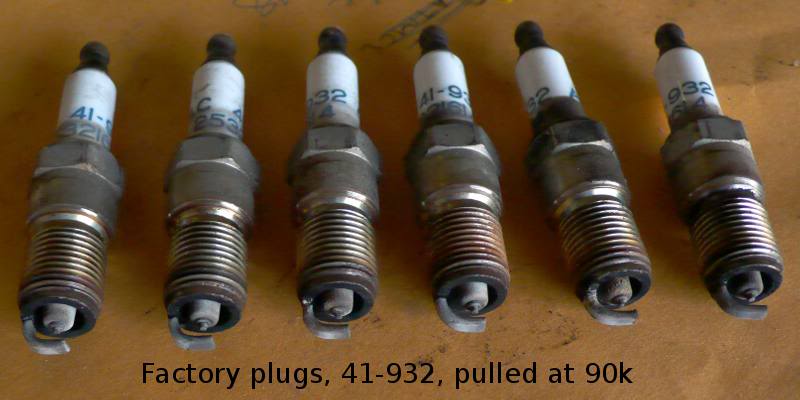

Old Sep 22, 2011 | 01:41 PM
silv99's Avatar
Member
Joined: Sep 2011
Posts: 40
