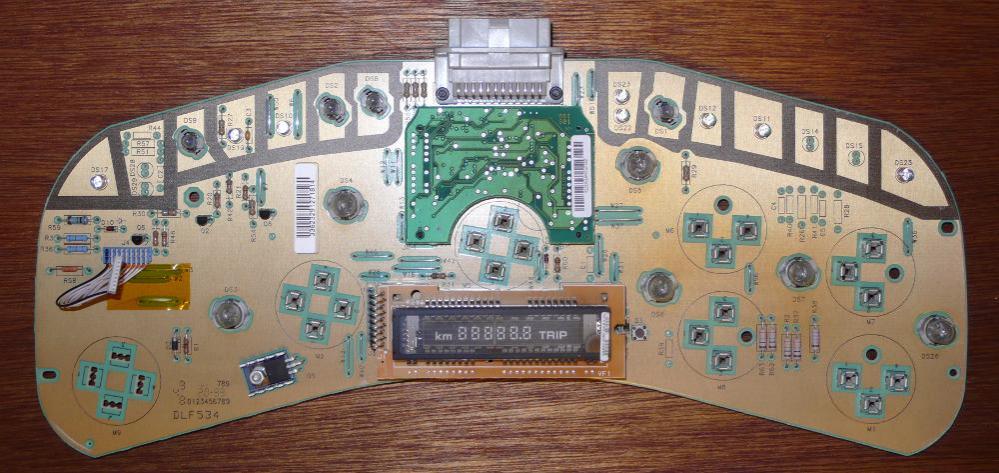

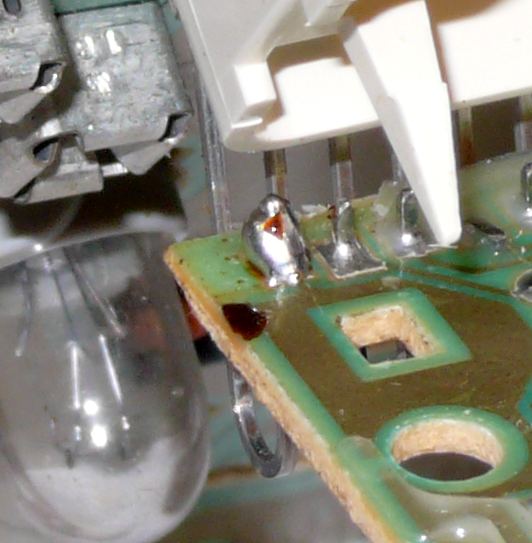

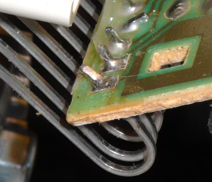

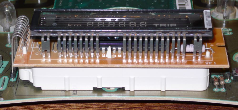

some photos from the repair ...
Attached Thumbnails odometer repair, DIY-p1160013.jpg.001.jpg   odometer repair, DIY-p1160014.jpg.001.jpg   odometer repair, DIY-p1160028.jpg.001.jpg   odometer repair, DIY-p1160037.jpg.001.jpg
