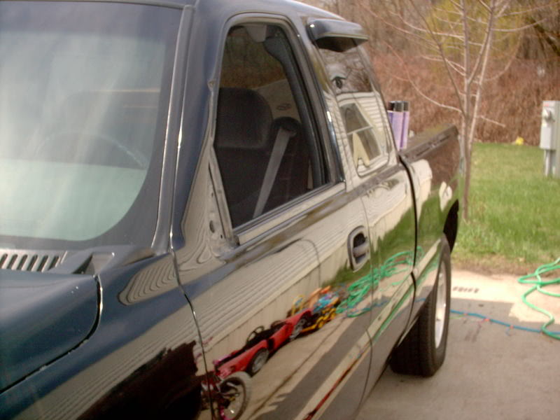

Oh yeah here is some picture's of mine with no mirrors I think it looks cool like that.

Here is a few pics of when they were off the truck. They might give you a better idea of were to look for the plug.
