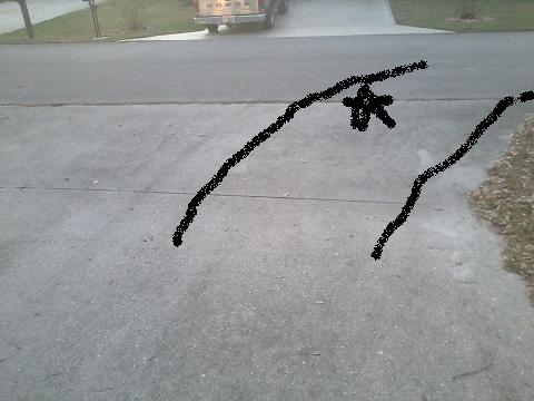

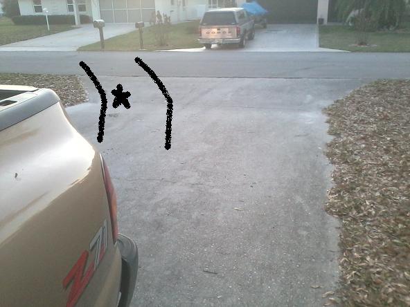

Ok guys im stuck.... Well it started out one day while I was driving home I smelled brakes while I was driving and it felt like it was dragging in the back and when I got home I smelled the back brakes and the smelled like they were dragging you know that strong brake smell.. So I figured Maybe a hose or caliper was going out. So I change everything Brakes, calipers, and hoses on both sides. Now here is where the problem starts.. When i try to back out of my driveway it will idle at a roll in reverse down the driveway but you hear some squeaking but as soon as I try to turn to get out my driveway the truck kinda stops it self(both ways over backing out) I uploaded pics and where the stars are is where it spins.. If I give it gas it will move with enough gas but the passenger rear tire starts to break traction and spin a little and leave a nice make in the drive way but the other tire doesn't. Do you think a master cylinder would cause this?I hope is not the rear end because the truck only has 55 000 miles on it and its a 2000... Any help would be greatly appreciated

maybe the emergency brake is broke and couseing the drive side rear tire to lock up? Because it hasent worked since I bought the truck. I believe the adjustment is on the drive side rear tire.. And that seems to be the one that seems to be locking up.. as you can see in the pictures
