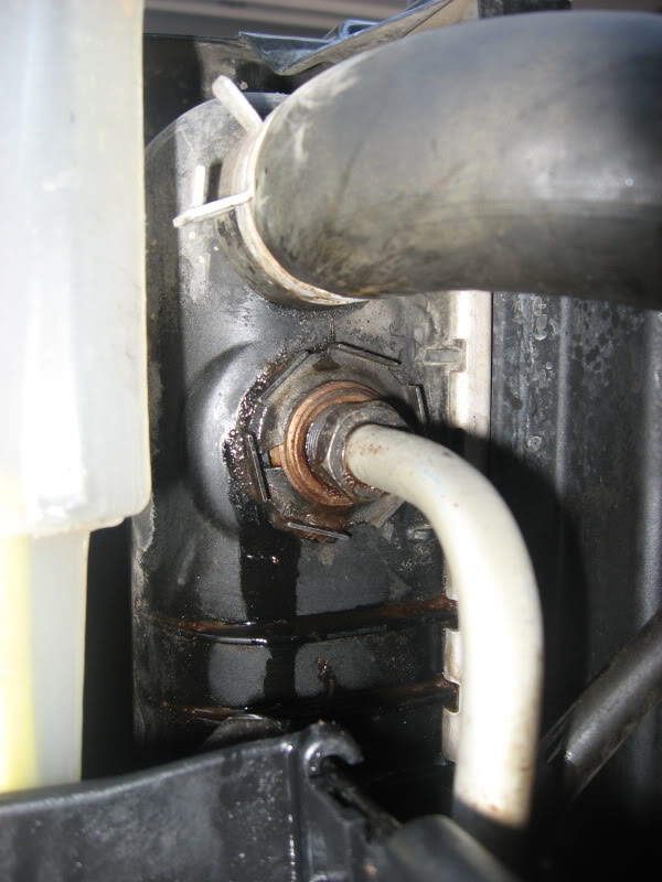

Need some help with a radiator leak. I have tried several of the stop leak products on market, seems to work for a while then the thing starts to leak again. Any help on how I can stop this area from leaking would be appreciated. Thanks, pic attached. It is on the drivers side, top of the radiator.

Vortec engine, driver side plastic tub, 3-6" down? Roughly 140,000 miles?
The best thing you can do is find a reputable radiator repair shop that will repair radiators with plastic tubs. I got mine fixed, flushed, and recored for $90.
For the time being though, you may want to try loosening your radiator cap to the notch before removal. This won't allow the system to pressurize, which is fine for short term, but it also won't get up to temperature.

been there done that also.........but couldnt find a cheap way to fix it.....so i bought a 4core radiator from oriellys for $239....well worth it in my book

Yeah that crack being sealed cold wont help, cause when it heats up it expands and breaks the band-aid. Time for new tanks.

Replace teh radiator... that is the cheaper method. Better than burning up a motor.
