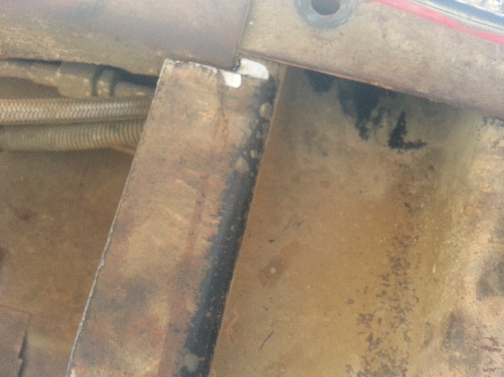

now for the more painful part, measure the old tranny and compare with the new. If your th350 is 3'' shorter like mine was, here is what you're going to need to do.
Fist thing is fist, you can't fit your cross member up the extra inch youre going to need. So you can cut a little slit in it to slide it past that downward brace like so.
Attachment 3547
after you've done that, you can shoot you're best guess and try to drill a hole under the premade hole in the cross member (or weld it if you prefer).
