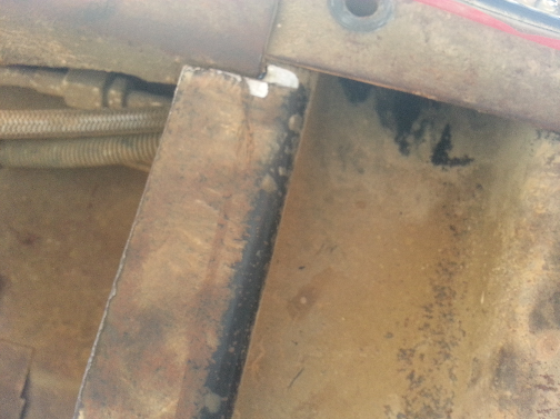

Fist thing is fist, you can't fit your cross member up the extra inch youre going to need. So you can cut a little slit in it to slide it past that downward brace like so.
after you've done that, you can shoot you're best guess and try to drill a hole under the premade hole in the cross member (or weld it if you prefer).
