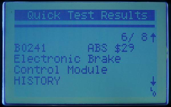

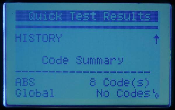

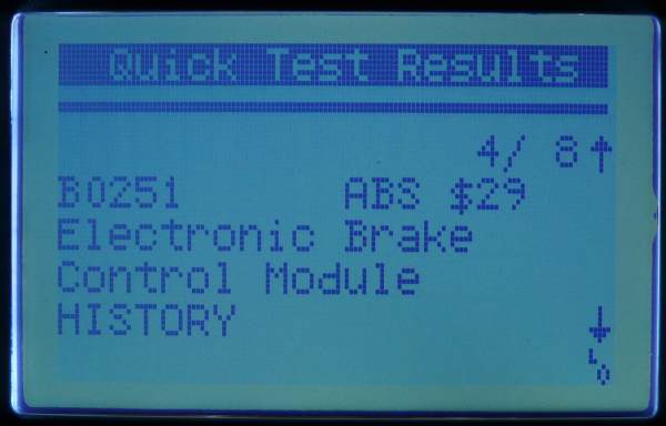

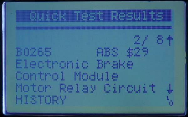

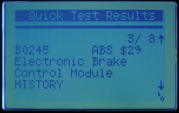

the full text from the CP9580 scan tool is this:
B0237 Rear Speed Sensor Erratic HISTORY
B0265 Electronic Brake Control Module Motor Relay Circuit HISTORY
B0245 Electronic Brake Control Module HISTORY
B0251 Electronic Brake Control Module HISTORY
B0252 Electronic Brake Control Module HISTORY
B0241 Electronic Brake Control Module HISTORY
B0242 Electronic Brake Control Module HISTORY
B0246 Electronic Brake Control Module HISTORY

update: used the CP9580 this morning to erase the ABS codes, then took the truck on an 8 mi round trip errand. at the beginning the dash ABS + Brake lites were not lit up, as is always the case on ignition. scantool kept reporting zero ABS codes until two dash lights lit up about 2 miles later. from that point onward, scantool reported one and only one ABS code: C0265.
before heading home, i erased the code. dash lites were out. scantool again kept reporting zero ABS codes until the ABS + Brake dash lights lit up about 1 mile from home, at which point scantool began reporting one only one ABS code, C0265.
