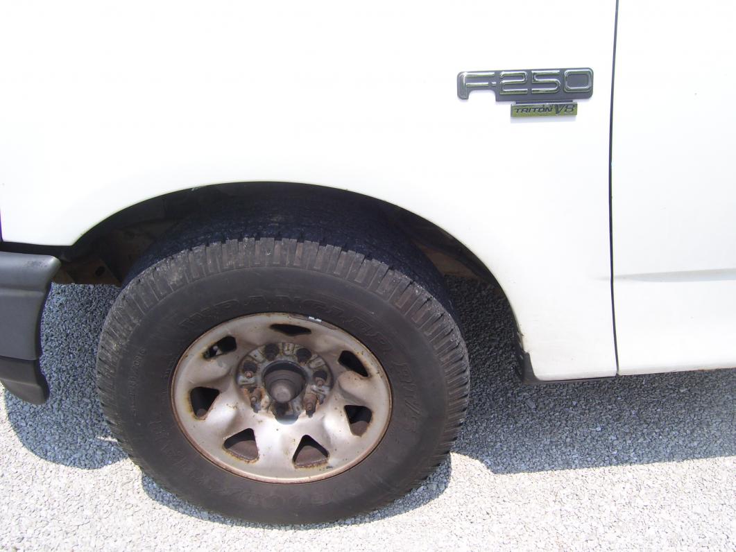

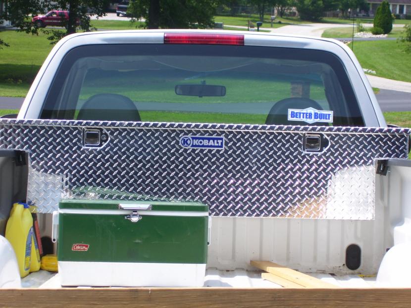

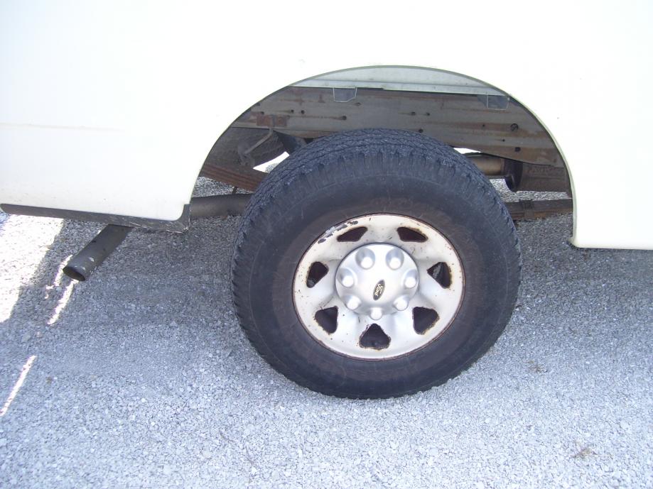

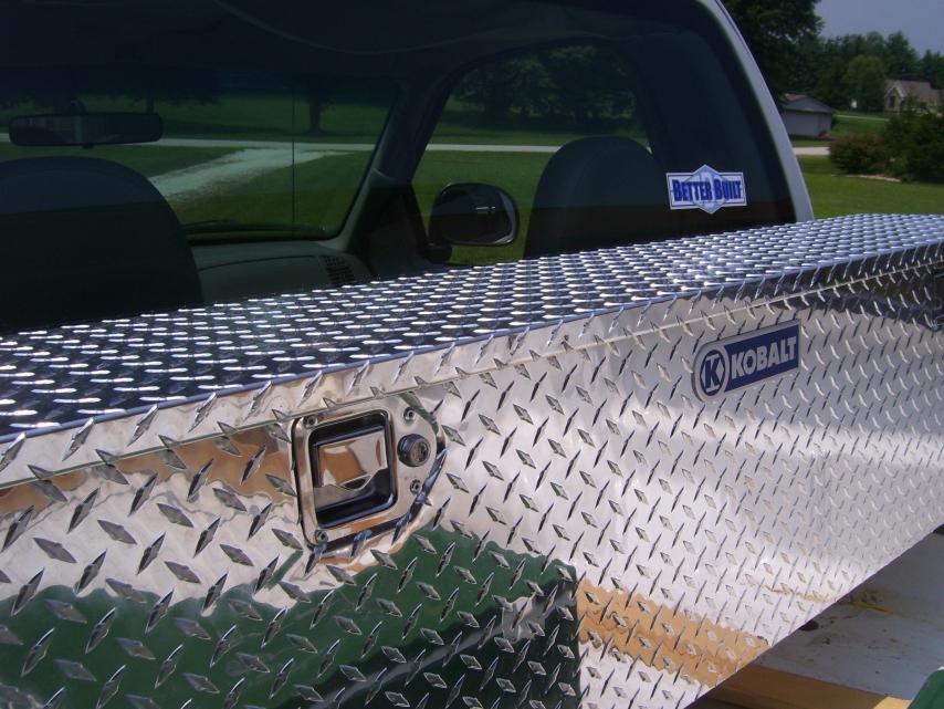

here is my truck i plan on doing it too.
