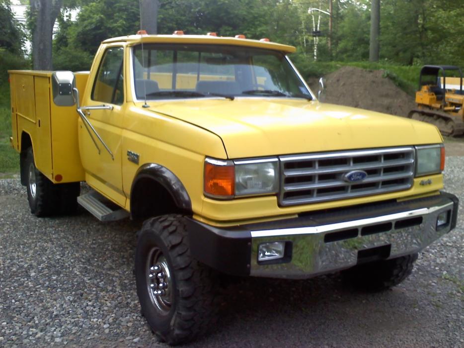

I am considering the idea of swapping a Cummins in to my Ford. I have an 88 F-350 and I just picked up a 1993 Dodge 3500 with a rotted body with a diesel and 4wd. I have asked around and I cant find anybody who knows how much of a project this will be. Anybody have any suggestions?
