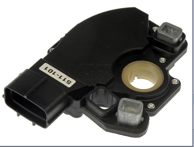

I got my F250 'stiff shifter' problem fixed !!!
It is the transmission range sensor located on the shifter side of the transmission. The sensor costs from 30 to 70 bucks depending on where you get it.
It is a simple plastic switch, that no one will think could bind up the shifter, but it does,,, two trucks here in town were corrected with this simple fix.
Place transmission in Neutral.
No need to disconnect shifting cable. Disconnect the wiring plug, remove two 8mm cap screws,,, pry off old sensor.
You will probably break the old one taking it off,,,and you need to buff up, and lube the shaft where it slides on.
Before installing new sensor, turn the sensor so the two lines on the white collar and black housing line up [trans in neutral ] then carefully tap or push sensor on shaft.
Reinstall bolts, and plug.
Then be careful not to jerk shifter out of column the first time,, it will really work easy now
