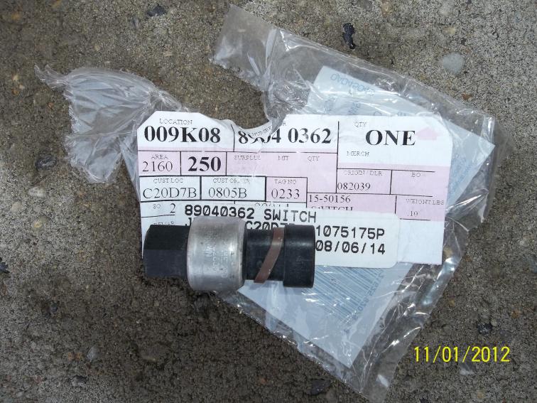

I was having this problem with my 2000 sierra. After verifying the charge level, monitoring the pressures and washing debris from my condenser the problem was still there. It seemed the more the system was used, the less intermittent the problem was.
I decided to change the low pressure cycling switch. At the parts counter, the parts guy noted that there was an attached tsb for this part. bulletin 03-01-39-007 addresses intermittent a/c operation, with the low pressure cycling switch being a possible fault. Even though the tsb is for model years 2002 to 2003, I bought and installed the updated switch which was listed for my 2000.
The updated gm part # is 89040362; my cost was $37. Its a simple screw in installation as the accumulator fitting has a Schrader valve; so the system does not need to be evacuated.
I will post back if it fixes it.
