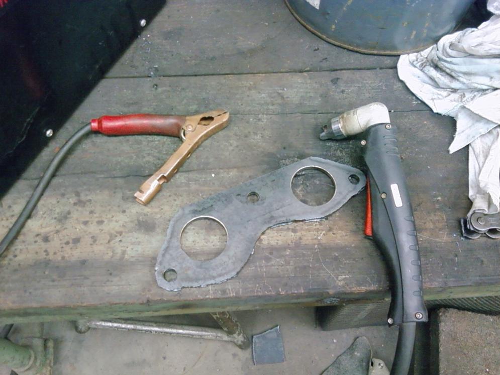

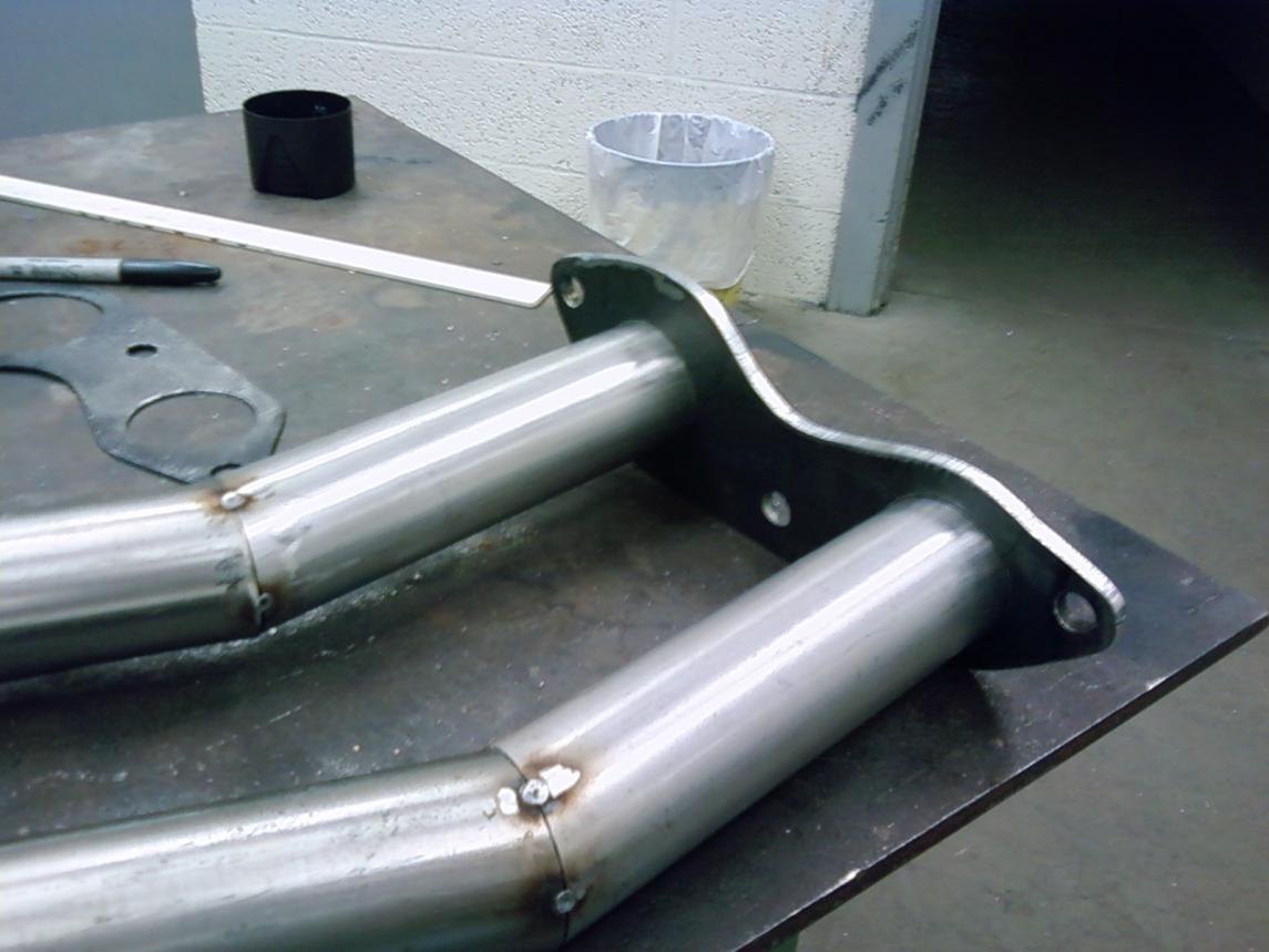

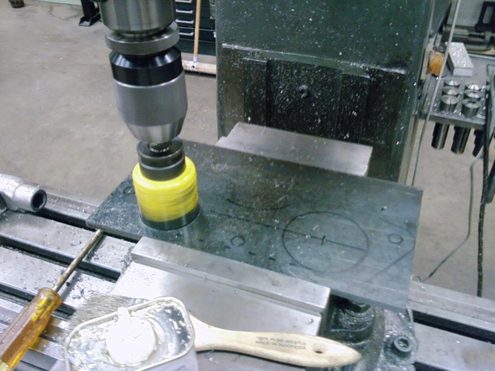

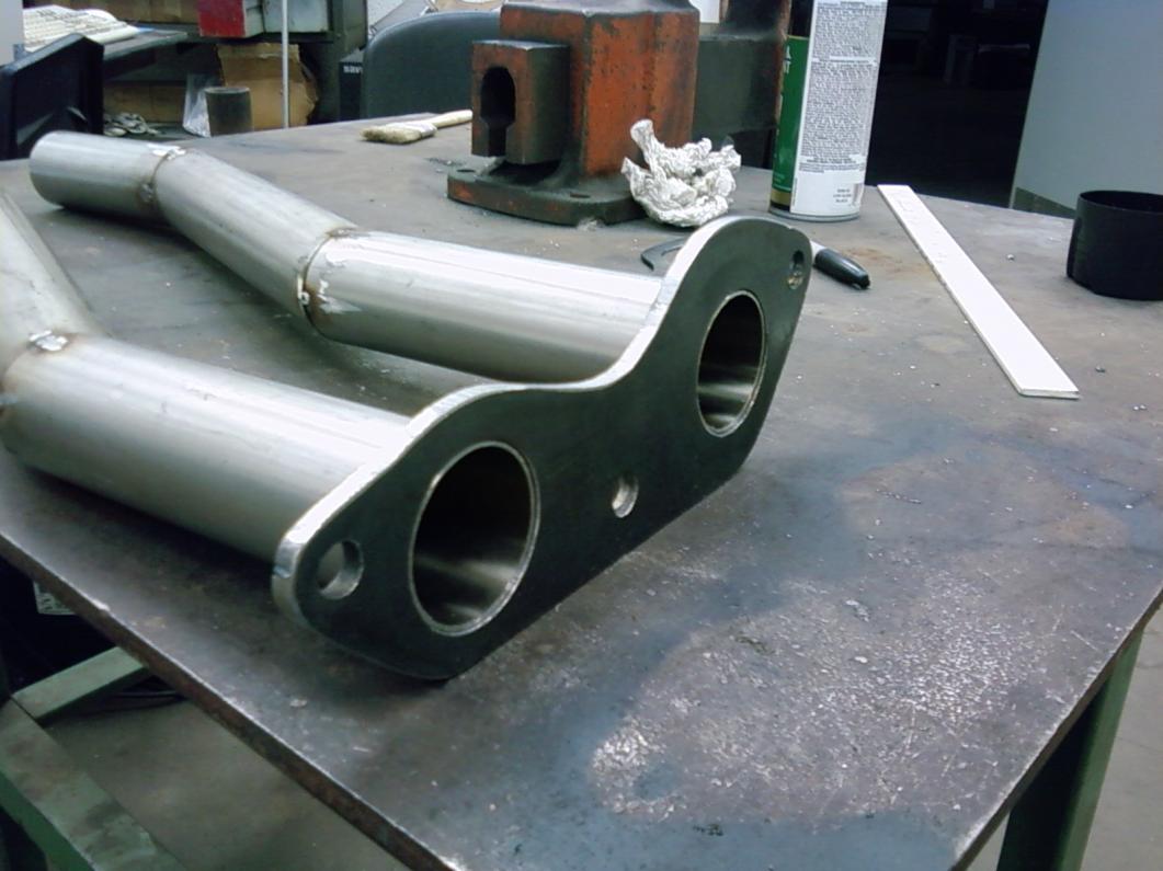

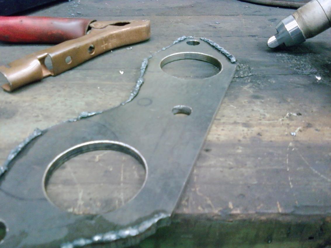

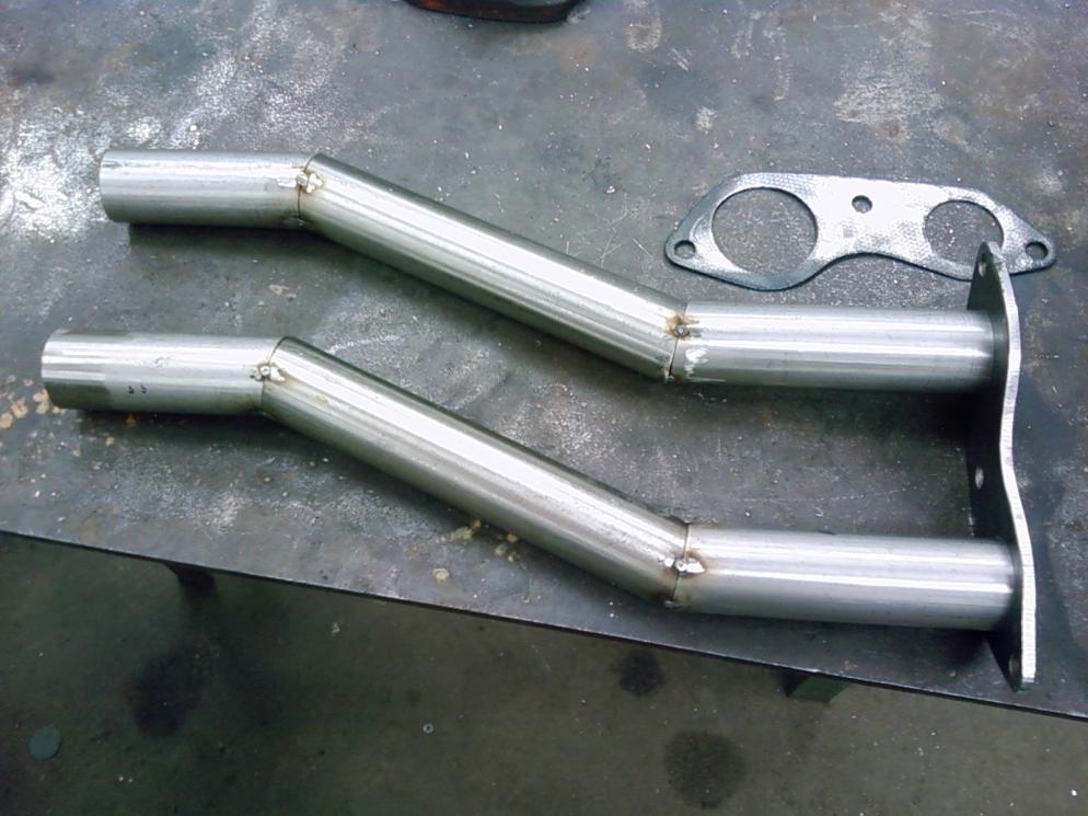

custom exhaust from exhaust flange to new mufflers. 1/4 inch plate w/ 2" hole saw and 2" ss tubing cut at 11 degree compound angles equal 22 degrees.
Attached Thumbnails 99 Chevrolet Tahoe exhaust Custom pipe flange-0303091926-00.jpg   99 Chevrolet Tahoe exhaust Custom pipe flange-0303092012-00.jpg   99 Chevrolet Tahoe exhaust Custom pipe flange-0303092012-01.jpg   99 Chevrolet Tahoe exhaust Custom pipe flange-0303092031-00.jpg   99 Chevrolet Tahoe exhaust Custom pipe flange-0303092031-01.jpg

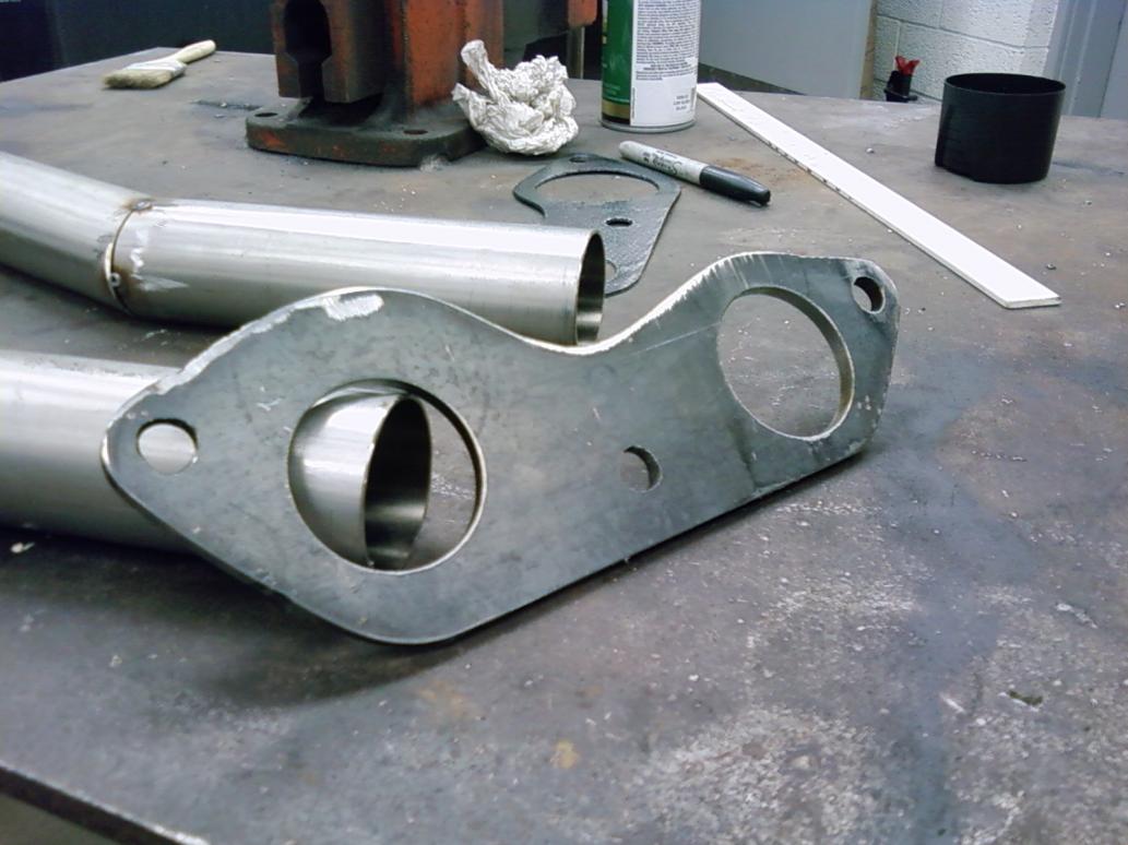

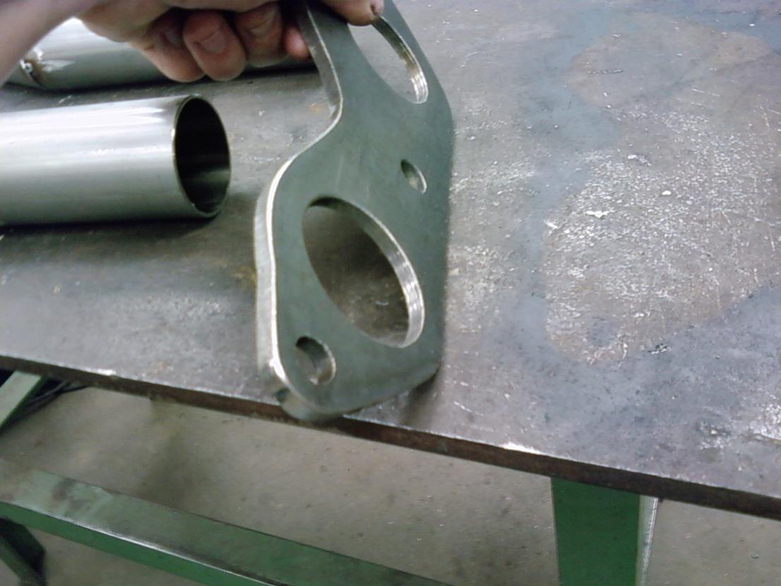

more pics of the exhaust. I could not find any stuff on this flange anywhere.
Attached Thumbnails 99 Chevrolet Tahoe exhaust Custom pipe flange-0303092032-01.jpg   99 Chevrolet Tahoe exhaust Custom pipe flange-0303092032-02.jpg   99 Chevrolet Tahoe exhaust Custom pipe flange-0303092033-00.jpg
