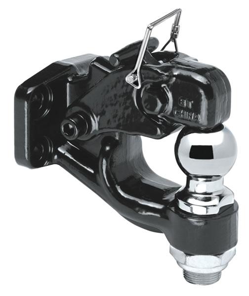

It's called a PINTLE HITCH. Normally NO it won't work with a conventional Ball Hitch style trailer.
Unless the pintle hitch is a universal style like the second picture.

I dont see a ball on there.......You can buy a ball mount that bolts in place of that pindle hitch. The trailer rental place should be able to help you out
There may be a square hitch under there. Then you just need the bar and ball
