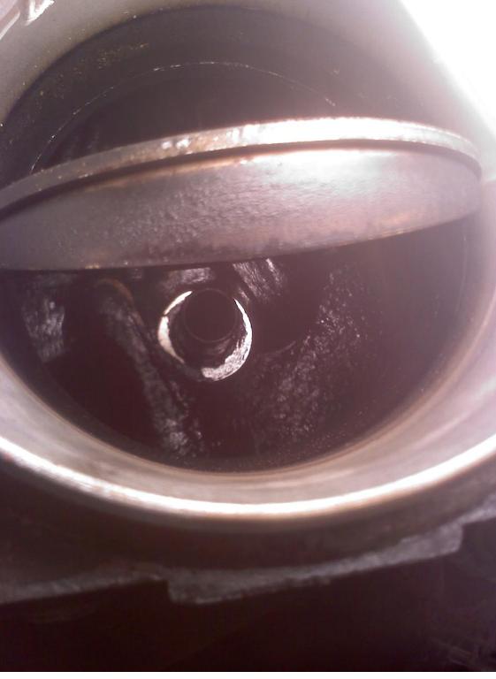

Uploaded (i think) is a pic of the inside of the throttle body. doesn't look to clean to me...

How many miles are on the motor? How about the MAF sensor is the screen clean and undamaged?

I don't have my specs in front of me, but that compression seems good. So that should rule out a valve issue unless it's a valve seal allowing oil to foul out your plugs on those cylinders. Need to find out if it is oil or gas on the plugs. These motors are notorious for the spider injection leaking which could cause plug fouling. I think I would pull the valve covers and visually inspect the valve seals and oil passages/drains to make sure you don't have oil puddling in your heads. If they look OK I would pull the intake and check the "legs" on the spider injection. While your there obviously you will need to install new intake gaskets, which is another common issue on the Vortec motors and could be the cause of your high idle (vacuum leak) and could contribute to your coolant loss. Hope this helps!
