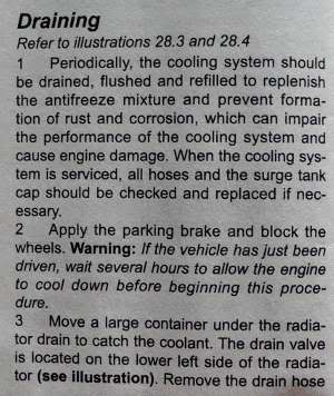

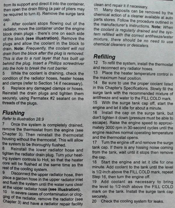

the instructions for 99-06 silverados do not mention a radiator cap, just the plastic surge tank, which uses a tight fitting pressure-cap

Your right there is not radiator cap, only the surge tank.

Dex-Cool is mainly for cast aluminum. You have cast iron which you can use green. I rid my 2001 5.3 of the orange and went with the green, kept getting gunk from the break down on the bottom of the radiator. Whe filling up, there is a certain way to burp the system.

i have the same engine and there is no cap
the plastic cap comes off with a screwdriver just pry it up and they can be just pushed back in.
when i did mine i pulled the bootom hose out and drained it like that and to burb the system i opened the resivior tank and held the truck at 2000 RPM and i got all the air out
