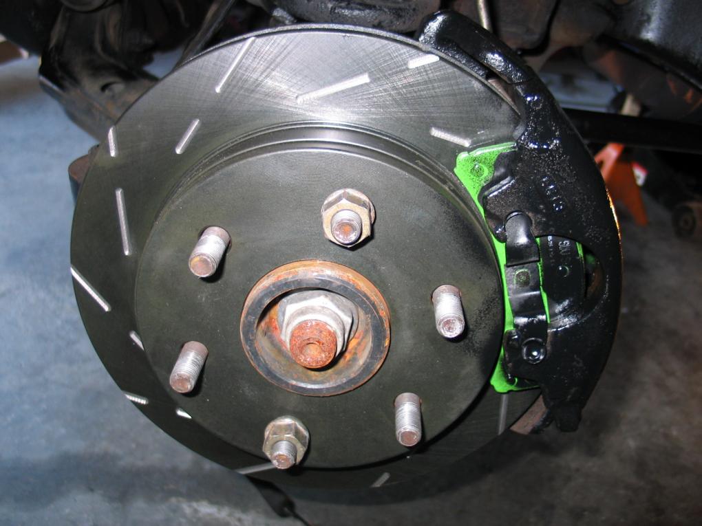

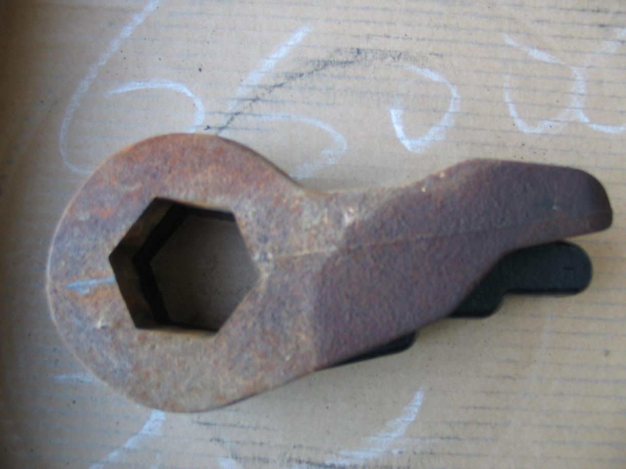

I've added EBS rotors and EBS 7000 series green pads. Combo kit master cylinder and booster. Bench bled master installed and bled system front and rear. I also replace the torsion bar keys to give my front end a 2.5" lift and added 2" lift blocks under rear leafs. Here is a few pics if anyone is interested. Thanks for all of you guys input.

Love your stepside! I've seen lotsa leaky master cylinders and didn't replace the booster, but it's ok to be safe. Ya might want to look in the cab where the rod goes from the pedal to through the firewall and pull back the carpet and look for signs of fluid leaking. That is the rear seal on the booster and if fluid leaks here it will rust the cab.
