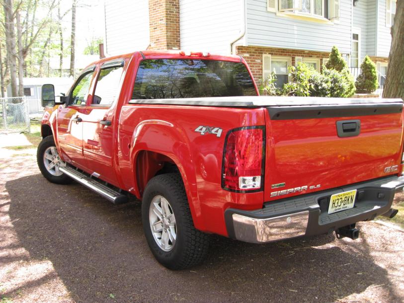

Ill swap you my stock 17's with P265/70/17 Goodyear AT/S with less than 6000 miles off of my 2011 Sierra with you.
