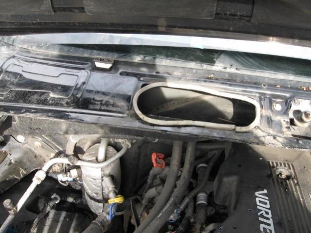

Good Day Everyone!
This is certainly not a truck-critical issue, but I thought I'd ask:
While chasing down a water leak in the cabin, I removed the cowl. (I think it called 'cowl'- it is the long, ventilated plastic part crossing under the windshield, below the wipers.)
There are some access holes in the metal: One is for the wiper motor, one for who knows what and so on. The hole immediately outboard of the passenger wiper mounting stud has a foam gasket kinda-sorta stuck around the perimeter. I attached a photo.
For all the information I could find, I can't figure out why this is there. It isn't like GM puts extra stuff in cars for fun. The cowl above this hole is slotted, so it isn't stopping water. I tired to search for the gasket in a parts look-up to see if it had a name that would be a clue. Nope! Just called "Gasket".
Do any of you know why this is here? And, should I replace it? (It is shrunk & won't make the perimeter any more.)
Thanks for any ideas!
Paul
PS: The water leak turned out to be the grommet retainer around the wires leading into the door. Its clips receded & it was not snapped on tightly. Wish I found this before I took a bunch of stuff apart- and broke the antenna base stud. Oops!

I would guess that is where the A/C system draws fresh air from and the gasket is there to keep whatever craps lands in cowl area from getting in.

Thanks for the quick reply.
I first thought that, too. But, there are a bunch of more holes nearby (also with air vent slots above them) that don't have gaskets.
Your reply has me re-thinking it & does make god sense:
Maybe this is the one that does the actual sucking-in of air & the others are passive? The cabin intake duct is only a few inches away.
A lot of stuff certainly gets under the cowl. (Maple tree helicopters were plentiful.)
Thanks Again!
Paul

the "cowl" you described is known as the "valance".

I did replace the gasket with some very similar foam strips I had left from putting in storm windows last fall.
I'm kind of glad I did dig in this deep because, while rooting around looking for the leak, I found what I guess is a third cabin filter under the dash that was plugged solid with leaves & debris. Never saw any mention of it in the owner's manual. Surprise!

A third one? I know of the 2 that sit side by side under there, but not a third - do tell.
Reply:
I didn't stick around long enough to figure out exactly what it is for but ..
If you push the 2 tabs to let the glove box drawer fall & look up toward the firewall & to the right, it is kinda-sorta visible behind a foam covered wiring bundle. It is a cheapy foam pad. There is a plastic grid across it. It is about 6 or 8" square. The filter looked like a project to remove for washing, so I blew it off with the air gun. A huge amount of leaves & dirt ended up in the trough under the valance. Must be important for something.
I found it while tracing the antenna wire. I broke the stud trying to unscrew the antenna whip to take the valance off. The plan was to take the base out- wire's permanent on the base- & replace it or braze a stud on or some other make-it-work fix. I ended up just drilling and tapping both the base -still in place- and antenna & inserting a brass screw with its head chopped off. It got never-seize this time! Radio works fine. Simple enough I suppose.

Thats a new 1 on me too. Anyone know what it is?

From what I can see on my wife's Tahoe that is where the air gets sucked in from the recirculated setting (inside the cab). Hers does not have a foam pad though. It is just the grid looking opening. She will actually every once in a while open and release the glove box and spray Febreeze in there to freshen up the vents.
