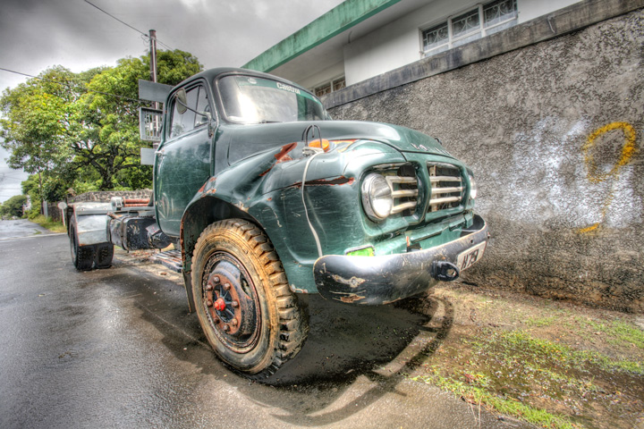

check these trucks reminds you the old days of bedford
