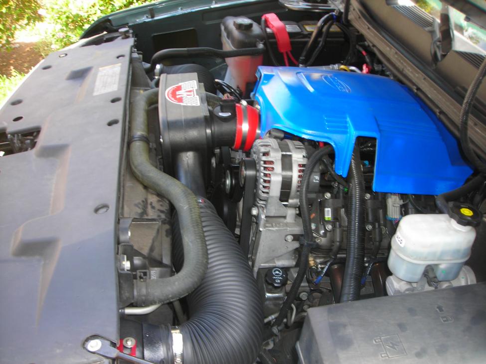

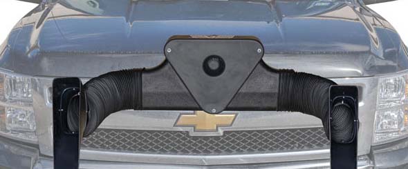

I finally got time to install it yesterday. It wasn't very hard at all, it took about an hour for me to take off the k&n setup and install this one. There are alot more clamps to double check on tightness. The hardest part was getting the main box with the mass air flow sensor to hook up with the throttle body. It wasn't that bad but since I have a throttle body spacer it gave me less room to work with but it still worked. Start up I noticed a change in the sound and the motor didn't run as high of rpms as it used to with a cold start. Accelerating doesn't take as much throttle to get going. At WOT it was incredible I won't lie with the K&N I did notice more of a throttle response but debated whether or not I felt more power. With this I did notice for sure there is more thrust and it ran about 500 more rpms before shifting into second gear. I haven't driven around enough to see any improvement/less improvement in mpg but I will be making a road trip in a couple weeks and I'll let you know how it goes. In the past I've gotten about 22 mpg on the road. The best I ever got was 25.7 (amazing! I hope to beat that though)
Attached Thumbnails Installing a ram air kit soon!-dscn2484.jpg   Installing a ram air kit soon!-tripower-truck.jpg
